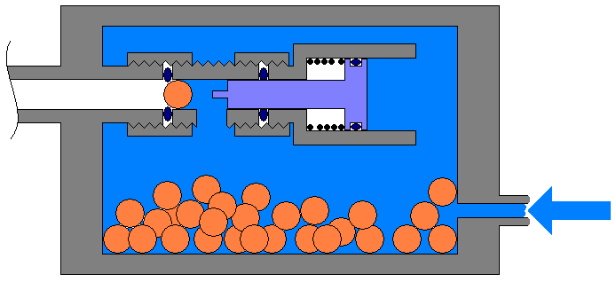

As some people are already aware, adding an airtight detent to the breech of a BB machinegun is a good way of boosting power as it allows pressure to build up in the BB chamber before the projectile is fired, translating into higher muzzle velocities.
The downside is that in most cases, a second BB tends to block the detent before the first has left the muzzle, resulting in erratic firing patterns and even barrel collisions which can damage the launcher.

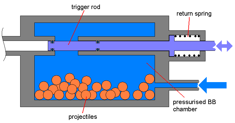

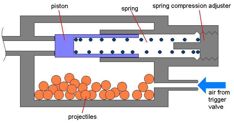

Here's a theory on how to achieve high BB chamber pressure without the need for a detent. The breech is blocked off by a spring loaded piston which essentially acts as a pop-off valve. This gives a minimum firing pressure before the breech is opened and BBs can be fired.
Another alternative would be to have the BB chamber permanently pressurised, with the breech closed off by a balanced spool valve which is directly connected to a trigger, ensuring there will always be maximum pressure behind the BBs.
Thoughts/comments?

bbs need time to agitate... something tells me the pressure will drop significantly before the first bb enters the barrel
so in my opinion you need to find a way to block the next bbs from entering the barrel before the previous one leaves it
remember the design with an air cylinder that blocked the flow of bbs ? that seems promising
I see your point but in this case if the pressure drops the piston will re-close...POLAND_SPUD wrote:bbs need time to agitate... something tells me the pressure will drop significantly before the first bb enters the barrel

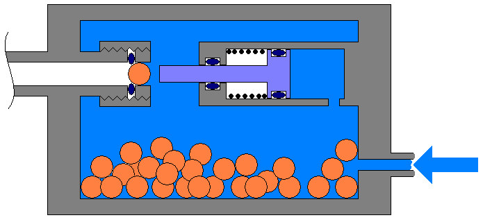

You mean something like this? With a weak spring on the piston, in theory it should work well enough, but there's a bit too many essential o-rings for my liking...remember the design with an air cylinder that blocked the flow of bbs ? that seems promising

naaah not really...but there's a bit too many essential o-rings for my liking
remember that you have a lathe... if you're really worried about leaks then you might as well put a small equalisation hole between the inside of the air cylinder and the outside of the gun

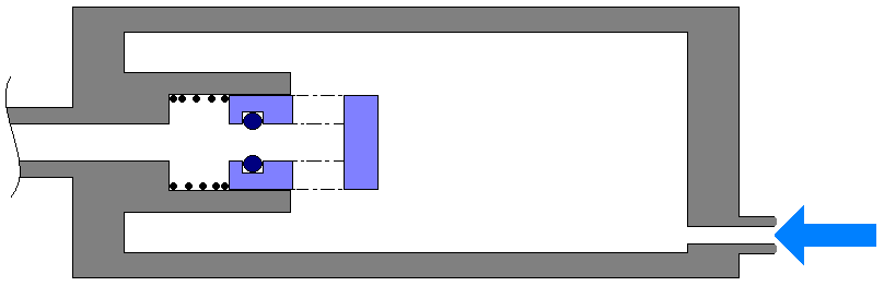

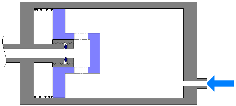

Here's another simpler variation that should work well without o-rings apart from the detent:
- bbmgdetentblockerv2.png (3.09 KiB) Viewed 54718 times

I doubt the first one you posted will work. I see a stepped piston and a pop-off valve, but I find it unlikely that the piston will retract far enough to let a BB agitate and load before it closes again.
The second design seems a more likely candidate, but I'd re-orient the BB chamber and air inlet, so the BBs are held in a thinner, more vertical chamber, so as to give good agitation when the valve triggers and blasts a lot of air out the barrel. However, this design again suffers from the problem that you must vent a lot of gas from the chamber to get flow and agitation for feeding.
Third design doesn't seems too complex and not serviceable at all.
I'm a big fan on the second-to-last design. Slap an o-ring onto the bolt piston thinger and it should work. My only concern would be finding an appropriate spring.
On the last one, the piston area ratios seems a bit small and thus prohibitive of rapid cycling, but it has the same merits as the one previous to it, with the possible issue of running out of space to cut an o-ring to provide sealing between the bolt and its housing. It's also not adjustable, which could make it a PITA compared to the previous one when getting it initially set up.

bbmgdetentblocker.png is really promising... I don't see any need to modify it

Honestly Jack, do what you think will work best. I agree with poland, bbmgdetentblocker.png is pretty promising.
I don't think so, considering it will only move when a BB gets stuck in place, and one that happens, flow stops.POLAND_SPUD wrote:too many moving parts that can be blocked by bbs
The idea is to have a high flow valve that will allow a long enough time interval for the BBs to go through. I also envision setting a pop-off pressure significantly lower than the feed pressure.I doubt the first one you posted will work. I see a stepped piston and a pop-off valve, but I find it unlikely that the piston will retract far enough to let a BB agitate and load before it closes again.
You're always going to vent some gas before a BB reaches the breech with any design so it's pointless worrying about itThe second design seems a more likely candidate, but I'd re-orient the BB chamber and air inlet, so the BBs are held in a thinner, more vertical chamber, so as to give good agitation when the valve triggers and blasts a lot of air out the barrel. However, this design again suffers from the problem that you must vent a lot of gas from the chamber to get flow and agitation for feeding.
Much as I hate cutting threads, attached a more plausible version.Third design doesn't seems too complex and not serviceable at all.
What will govern rate of fire is flow into the barrel, the pistons only serve as blockers that actuate when there is pressure in the barrel and release when pressure is released.
The attached should work beautifully, I'm trying to figure out if there's a simpler way op putting it together.Honestly Jack, do what you think will work best.
- bbmgpistonblockermod.PNG (12.18 KiB) Viewed 54658 times
