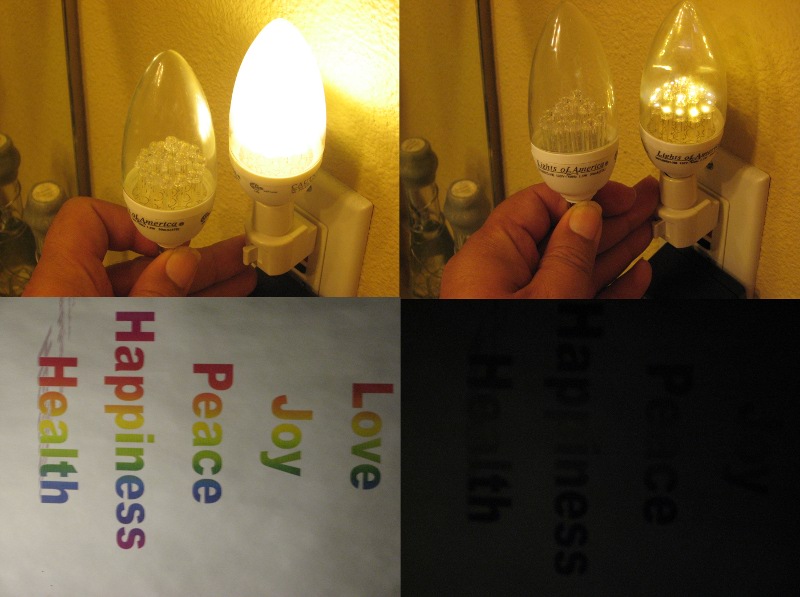

I have been watching LED technology make great advances lately. One item not solved to my knowledge is a little known issue of Lumen Maintenance. What this means is as LED's age, the Lumen output degrades. Most consumers are not aware of this issue. Now that a large number of TV's and laptops come with a LED lit LCD display, I worry about the lifespan of the light. From what I have been able to tell, the life is much shorter than the common cold cathode lamps of old.
Consumers are assuming that solid state LED lights are rock solid and are unlikely to fail. Since I have first read about Lumen Maintenance, I have looked into the issue and running some tests of my own.
The first test was with LED Christmas lights. We put some up two years ago and were impressed. One of the strings had high failure rates of the Green LED's. Last year we bought some more LED lights. My daughter really liked some of the blue ones I got. So she put up two strings in her room. One was completely dead in less than 6 months. The other was dim with many barely lit at the same time. It was about this time I heard of Lumen Maintenance.
To run the experiment, I picked up a package of LED bulbs from Costco. It was a package of 3 bulbs. One was placed in service in a bathroom with no windows to serve as a night light. It was on 24/7. Another bulb was placed in the headboard of my bed for occasional use, and the 3rd was placed with my camp stuff for low power battery inverter use while camping. Below are the photos of the direct comparison of two of the bulbs. One is from the bathroom and the other is from my headboard.
To prevent the camera from hiding the result by changing settings, the camera was set to Manual exposure to use the same exposure for both photos. Two pairs of photos were combined into the composite photo below. Two pairs of photos are of the bulbs in use with the bathroom lights on and two of a paper on the wall lit only by the LED's.

My concern is if you use a computer or TV with LED lighting 8 hours a day 5 days a week, it could have faded as much as my example in under 3 years. The bottom two photos could easily represent the screen brightness of a TV or monitor that is used daily for work shift after only 3 years of use.
In photography one F stop change or one shutter speed change will double or half the exposure. Without making any change, it is easy to see that my fade was way more than 1 f-stop. This lamp has faded well below 1/4 output in under a year. The blue Christmas lights in my daughters room did the same thing. My concern is they are now using these in TV's and Laptops.

If used 3 hrs a day, they claim a warranty for 3 years. The yearly estimated cost to run is about 30 cents since these are only 1.5 watts. The real cost is the bulbs. A package of 3 is about $20. In your laptop or TV the energy savings won't pay a shop to re-lamp it in 2 years because it is dim.saefroch wrote:No offense, but if you're watching 8 hours of TV 5 days a week... I'd have other concerns.Technician1002 wrote:My concern is if you use a computer or TV with LED lighting 8 hours a day 5 days a week, it could have faded as much as my example in under 3 years.

There was a test on light bulbs regarding their efficiency and life. An issue with both conventional and worse with CF bulbs is they do not last if they are cycled on and off often. On the converse LED bulbs fade if left on constantly. With this in mind I just changed out the bulbs in my small bathroom with LED bulbs. The ceiling light was 60 watts. The three bulbs over the sink were 40 watts each. To make a long story short, I replaced 180 watts of bulbs with 4 2.5 watt LED bulbs. It is not quite as bright as before, but will work fine for my use. I don't spend 3 hours a day in the bathroom, so this should work fine for the relatively frequent operation of the lights.
Too be fair the camera did some great color correction on that photo. The bulbs are listed as warm white. With the camera flash, you can see they do a decent job looking like an incandescent.
I am not ready to replace lights in the other rooms yet until I see better LED life.
