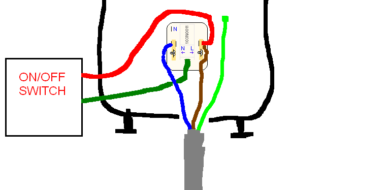

Here is a pic of the PTC relay seen from the top. There are 3 connectors there labled L (for line), N (neutral) and C
CLICK TO SEE THE PICTURE - for some reason it doesn't display properly
To wire one you have to connect line/hot/phase wire from the cable to L one the relay. Then attach neutral wire to N on the relay... Sounds fairly easy huh?
In order to switch the compressor ON you have to run a wire from L to C - that's where a thermostat is normally mounted - and that's where you should put an ON/OFF switch
the compressor won't work unless there is a direct connection between L (hot/line) and C on the PTC relay

it's based on colour codes used in poland (applicable to European Union (EU), Australia, South Africa (IEC 60446)) - check this wikipedia article to check standard colours used in your country >>>> http://en.wikipedia.org/wiki/Electrical_wiring )
