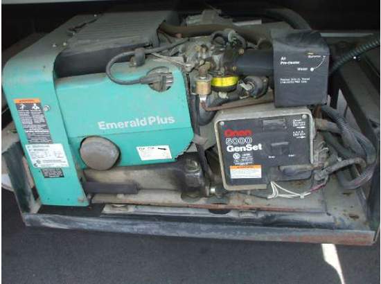

I have a new toy taking up my time. It includes a way to haul all my cannons and a 40 Amp generator to run a larger compressor.
I'm taking care of a few minor problems on it as it is 18 years old and needs some work.
Planning a trip later this summer.
I had to fix the electric step, a leak on the front windshield, and upgraded the TV to a flatscreen to double as a monitor for a backup camera I'm installing. Added an inverter to run the monitor/tv. No need to crank up a 4.8KW generator to run a 40 watt TV.

- 40 Amp power supply.
- 104067534_3thumb_550x410.jpg (28.23 KiB) Viewed 7761 times

Wifi is going in too. Added a 20 Amp outlet in the generator compartment for use with a larger compressor or to feed the house in an outage. I'll get photos of the improvements later. Future plans include ~ 1KW solar electric. Can't buy trip gas and the solar in the same year, so it is on hold.
