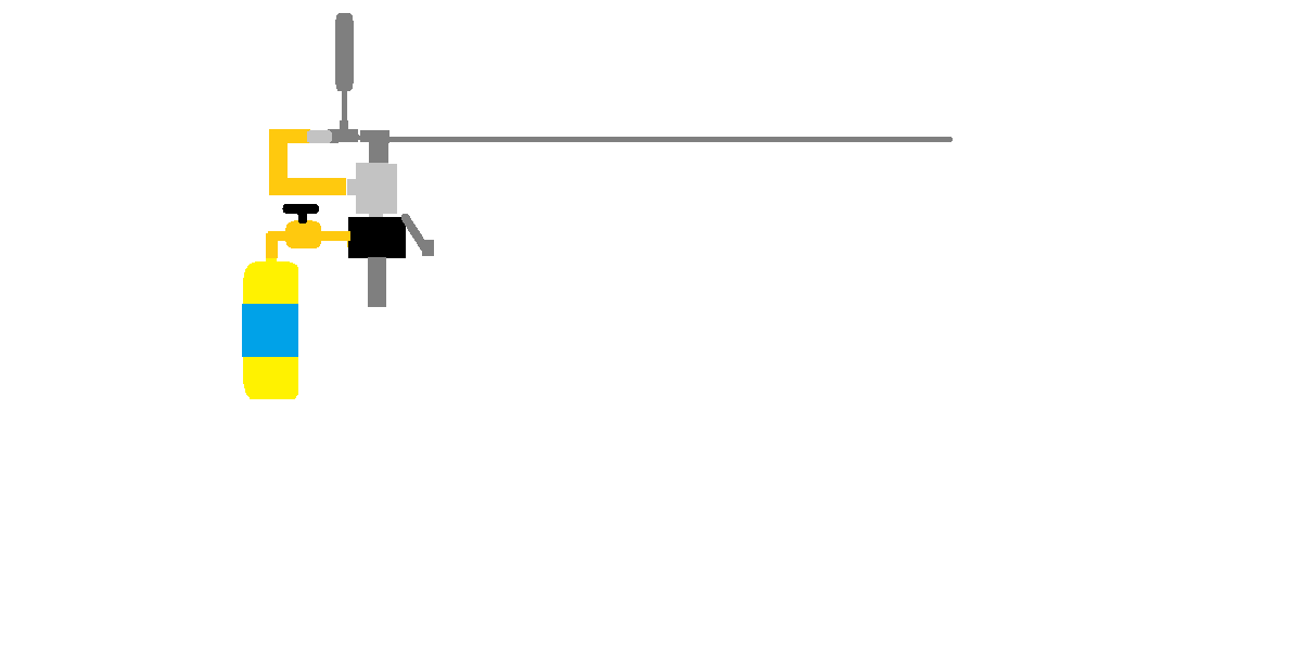

I have been researching semi auto pneumatic guns diligently the past two weeks. I have found that aquiring semi auto is not the hard part, but aquiring portability is. I have been exploring the options of co2 and propane as my power source. I like how co2 is more consistent and yields higher psi, but I also like how propane is cheap and easy to come by. I have heard mixed reviews about propane. Most of the complaints about propane are about how LP (liquid propane) freezes valves and other components of the gun. Some people have installed expansion chambers and hoses. This is where I am confused. I understand the purpose of an expansion chamber, but don't fully understand how to make an effective one that works with my design. My semi auto design consists of a 3 way direct control valve that pilots a qev that is connected to a small chamber (I did not make up this design I got it from Poland_Spud and Jor2daje):

The propane fills up the chamber, which is attached to an air cylinder.  The Air Cylinder (with a magnet on the end of the rod) pushes a bb into firing position.  The The 3 way valve is then triggered, which pilots the QEV.  When the QEV is piloted, air is released into the barrel.
Co2 can freeze valves.. it's not limited to LP

yes. does it look like this design would be vulnerable to freezing.

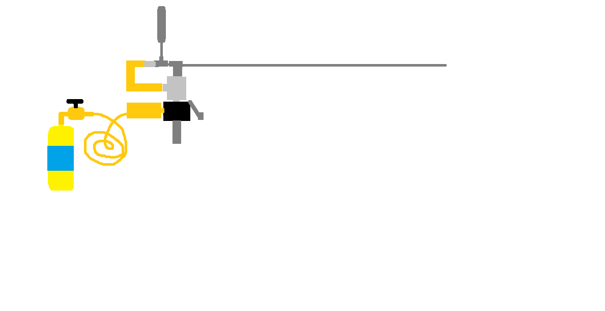

would it significantly help freezing if I connect like 5 ft of coiled hose inbetween the propane tank and the 3 way valve or would it be better to build an expansion chamber.
you should try to keep liquid propane from entering the valve
it wouldn't hurt to have a lenght of air line between the tank and the 3 way valve
plus it would be nice if there was a short lenght of iron pipe to act as an expansion chamber... anything that helps to absorb heat from suroundings will help... you might even put coiled copper tubing between the tank and the valve
I understand that the gun hasn't been built yet ? well then just build it using threaded fittings and see for yourself how well it works... if it doesn't perform well you can rebuild it in a few minutes

yeah coiled hose sounds ok... copper would be better as it's a better heat conductor, but it's semi rigid

thanks for the suggestions. should i use math calculations to figure out how big my chamber should be to be most effective. I am going to be firing 4.5mm bb's and my propane tank will probalby be the 14 oz size

how does this look. Does it matter how big the expansion chamber is, I would imagine the bigger the better, but after a certain size does it become less efficient.
