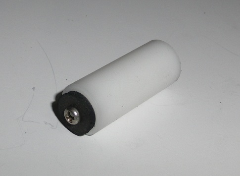

Here you go ;)
Jack, I might employ your services soon. I'll get a sketch together.
Will be away from my tools for February so if you need something urgent let me know asap.

If that's mine, looks really good! I'll PM you my address.
