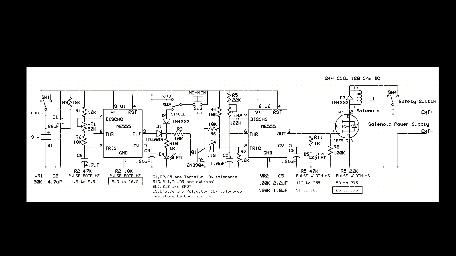

All that was left was to find a way to be able to pulse a current to the solenoid to have select fire. Zues stepped up with the idea to control it via a 555 timer. This was a little above my electronics knowledge and parts availability, so he so graciously offered to build it for me. This is the heart of the gun, without it it would be just another semi.

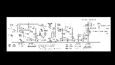

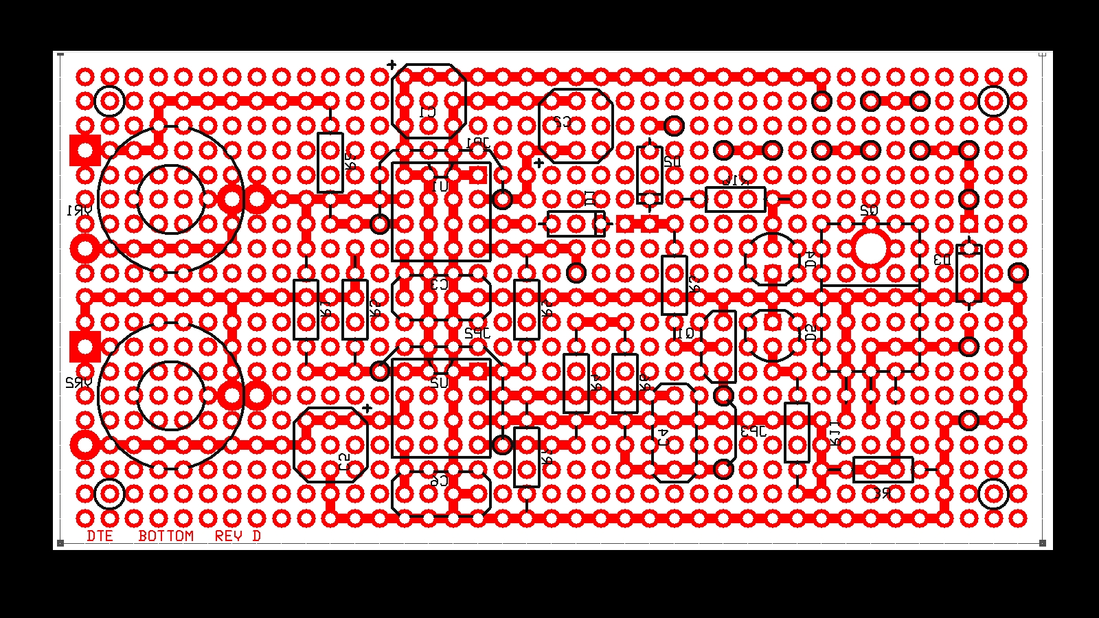

Zeus, I will post the schematic and board layout in this thread tomorrow.

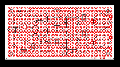

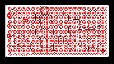

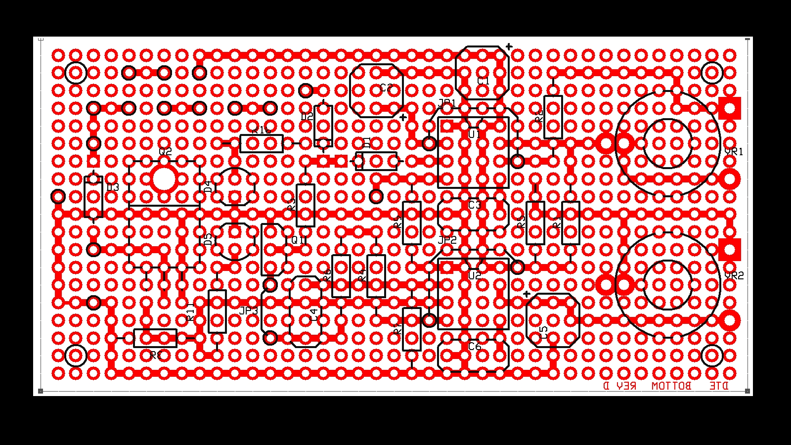

Here is the schematic and board layout.
Note there is a component view and a bottom foil view.
I recommend the "safety switch" on the 24V supply because the 555's have a tendency to "pulse on" during power up.

Zues, I will probly get u to make another later when I start another build, for the same reason (solenoid striking a hammer)
Safety is a big one, would like to have a working safety switch so the gun can't be accidentally discharged.
And those diagrams make no sense to me

Use a solenoid to open a hammer valve is not that easy, at least from my experience. Zeus if you have time do you want to build a circuit for me too? It's similar to this one, I think we can work out a price.
