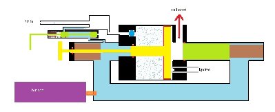

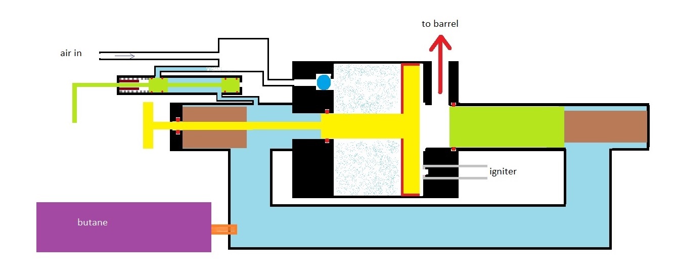

while the combustion happens the green piston moves back ....pressure extends to the barrel and drop down...the yellow piston start to move from left to right, vent the chamber and sucks new air/fuel behind it... (this is the moment the drawing show us)....than the green piston loss his velocity and moves back against the yellow piston, push it back to left and the fuel/air mix can reach the other site of the yellow piston. the piston strikes the fuel meter...ignition..
i hope you can understand it

well this is the fundamental concept but there are some problems to solve before start to build it. this design is relative complex and need some skills and tools to build. the goal is to make it buildable with tools in the basement. (no lathe or extraordinary machine skills)
-will it work?
- is there any way to reduce the numbers of o-rings?
- any way to make the fuel meter more simple
- may an other configuration of the components
- make it serviceable..
what ever... i need suggestions
at the moment i cant build this thing because there are to many problems in fabricating the components... example: is it possible to make the fuel meter absolutely air/gas tight? or is there an other way to meter without the need of absolutely air tight.
