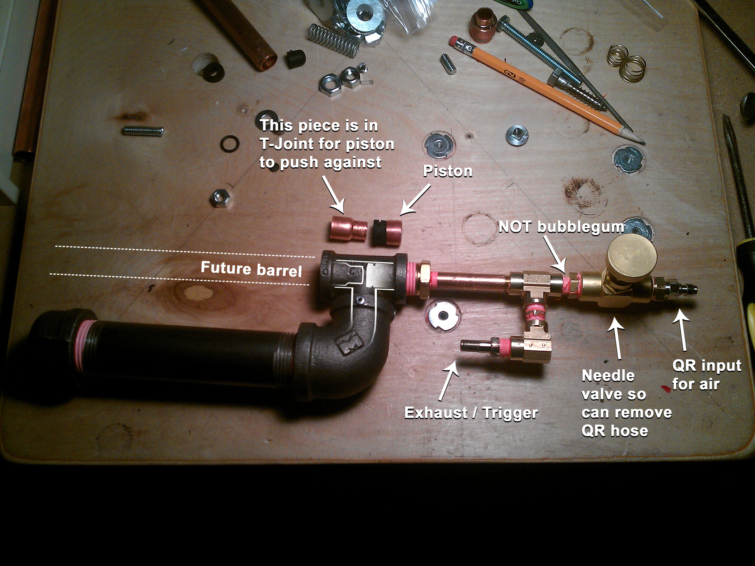

Working on second gun, in the picture you can see the setup I'm attempting...
I've watched wyz2285's YouTube video on the QEV/piston valve and Clide's helpful flash animation for the barrel seal. I want to make sure I have the concept down before moving on...
I believe I have the tapered copper fitting and piston sealing together in the right place above the air chamber opening in the picture, yes?
How far does the piston have to travel backwards with release? Just past the lip of the air chamber opening so the HPA can travel through the barrel and when equalized the spring, behind the piston, can once again push it against the tapered piece?
Thanks.
air_dannon wrote:I believe I have the tapered copper fitting and piston sealing together in the right place above the air chamber opening in the picture, yes?
Yep - the problem is that the copper fitting is going to go through that rubber seal like a cookie cutter.
You need a wider area for the piston to push against to spread the load.
Approximately 1/4 for the barrel diameter to achieve full flow, but typically one is advised to up that to 1/2-3/4 barrel diameter to avoid the piston bouncing back.

You may have issues with the pilot not triggering the piston valve. There are two reasons I say that. First there is a good bit of volume behind the valve, and second the trigger valve looks like the opening may be kind of restricted. I am only basing that on a glance at your image and I may be wrong, but if it doesn't fire you might look into those two areas.
On the sealing surface cutting through the rubber piston face... That may be an issue as well. It will depend on how hard the rubber is, how smooth and rounded the sealing area is, and how much pressure you use. I used a solid teflon piston in my mini gun to resolve that problem, but it seems to only seal with a rapid application of high pressure. In that case it works great when charged with a CO2 cartridge, but not when charged with a bike shock pump. When I used a rubber faced piston it worked with the shock pump, but the rubber seal didn't last long at all. The good news is that it is pretty easy to tinker with different pistons and piston faces. Still, best to avoid the whole problem by having more sealing surface as Jackssmirkingrevenge suggested if possible.

i think that if you put a peice of 1/4 inch pipe and put it inside so that it wont cut your piston.

Thanks, guys. I was wondering about the volume on the backside, PeteS... the Schraeder valve will have the lip cut down to expose the pin for the trigger in the end, but does anyone else think that much volume will be an issue?
Also, the little testing I've done so far, the piston is hard to seal when using my handpump, which is going to be the air source. I guess I'll have to play with compression springs.
I'll make the sealing barrel bigger and look into a different piston material.

Behind the qev you should be fine because it will work about the same, but do make a sutable trigger for the shrater intead of cutting it down.

Thanks, DG. The valve needle wasn't going to be the actual trigger. I was going to cut down an eighth inch so the needle would be exposed to a sliding trigger yet to be made. Is exposing the needle like that a known problem-in-the-making?

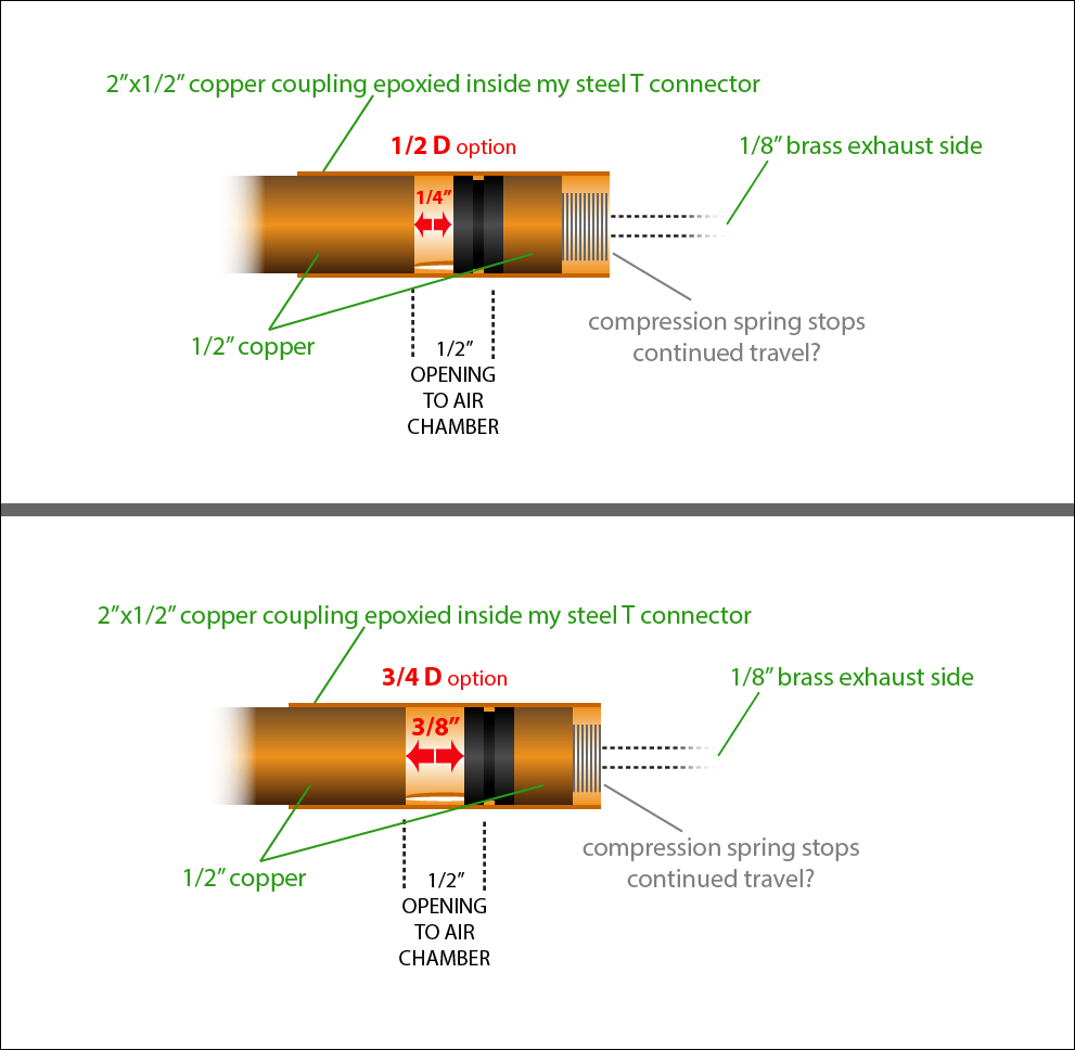

Needed to work it out visually for myself. This is also going with a larger sealing side 1/2" copper (which is also the planned barrel size).
Are the spaces the piston needs to travel back in these 1/2 ID and 3/4 ID versions of my setup correct? And which is the better choice?
Will using the 1/2" copper for the sealing side help or hinder the explosive air power? If so, what would be a better fitting setup to a 1/2" barrel?
Also, the compression spring... Am I right in thinking it needs to be long enough to at least push that piston against the sealing side, but also loose enough to compress to the amounts shown in my diagrams? Obviously I don't want the spring pushing the piston shut before the full flow is evacuated, but taking this gun to 350-400 psi like I want, is that concern not even an issue?

Exosing the needle could be a huge problem because you could melt the seal if you get it to hot or you could break the seal by hiting the needle.just make a wooden block with a hole drilled in the back to fit the outside of the valve and place a bbinside the trigger. also use the edit or hold off on posting untill someone answers a double post is actualy against the rules.(i was repremanded for that)

@DG - Those are good points for not exposing the pin, I'll make the "sleeve" version you described. Double posting, I get it... I should have just added (edited) my second post to the prior. Thanks.
Does the rubber seal exactly against the sides of the pipe?
@JSR - Yes, it does seal against the sides. I've removed the thick, softer rubber washer and instead cut a piece of bike inner tube and epoxied it to the piston head, then put it on my drill/apartment living lathe and sanded the rubber tight to the lip. Also, for the inner 1/2" copper sealing edge, I put extra pressure on the tube cutter to bend it inward and make the cut have a sight bevel that is then sanded smooth. I read the link, and another one the search feature offered at the page bottom,... starting to get it, thanks.
