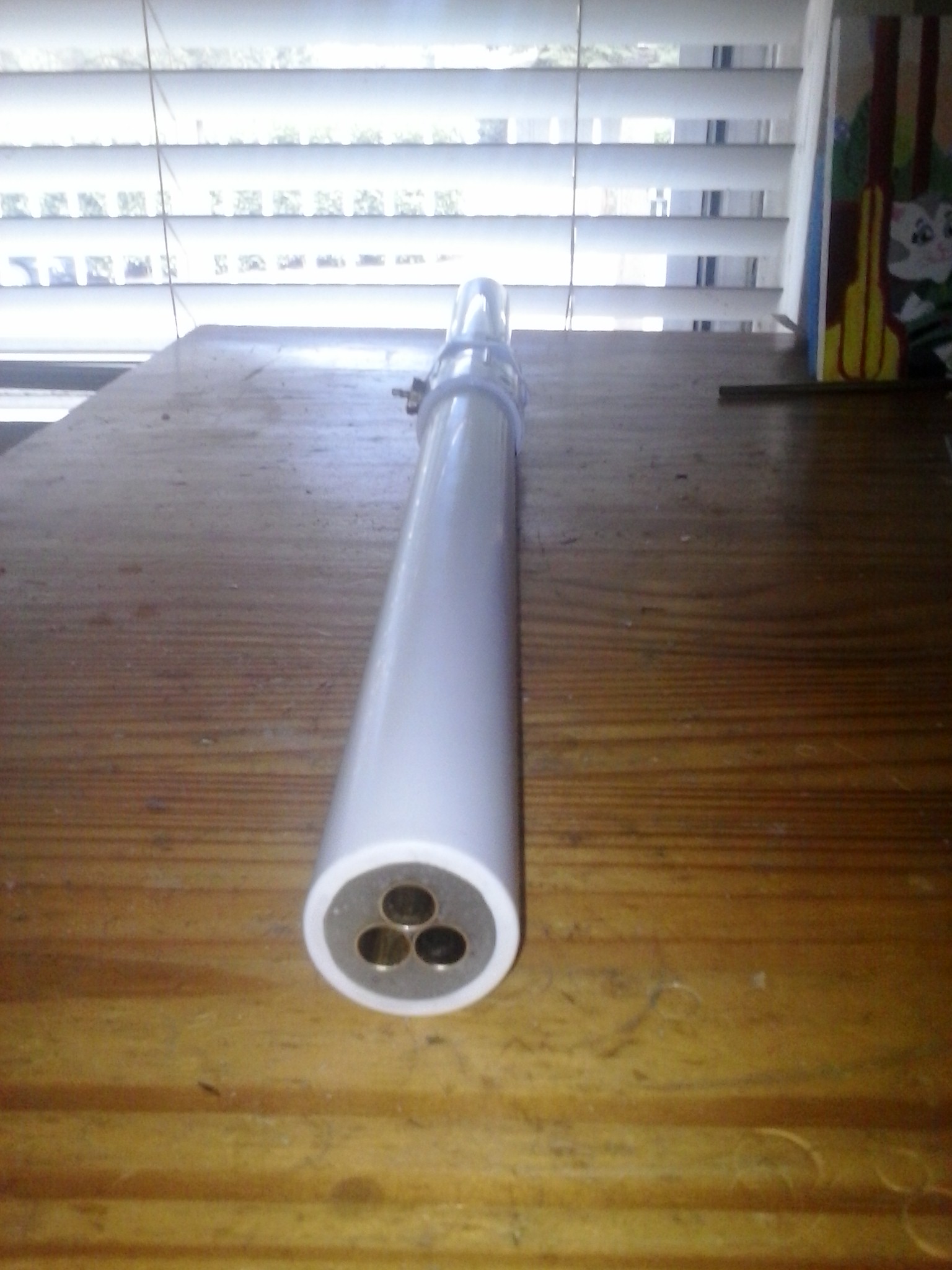

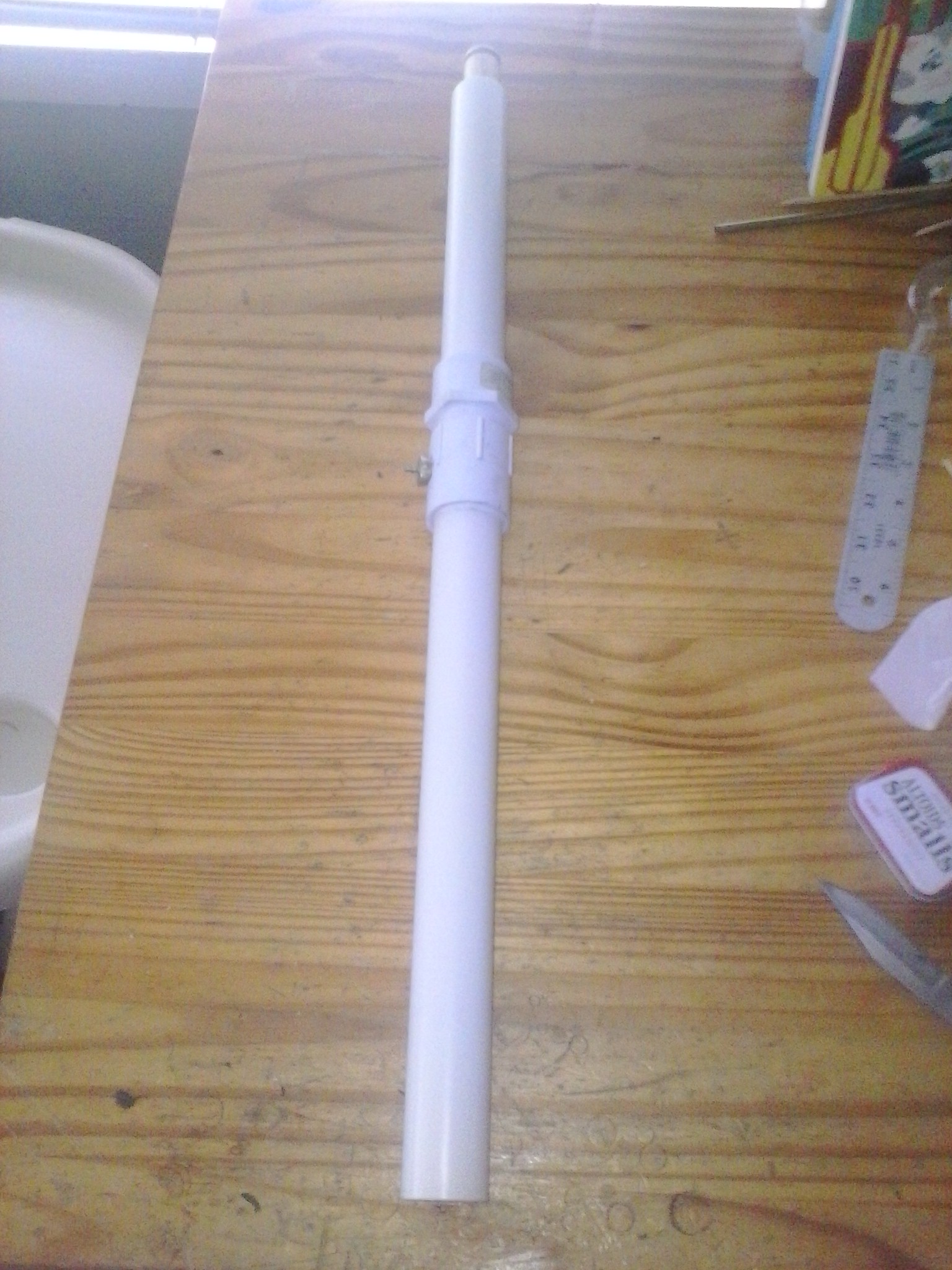

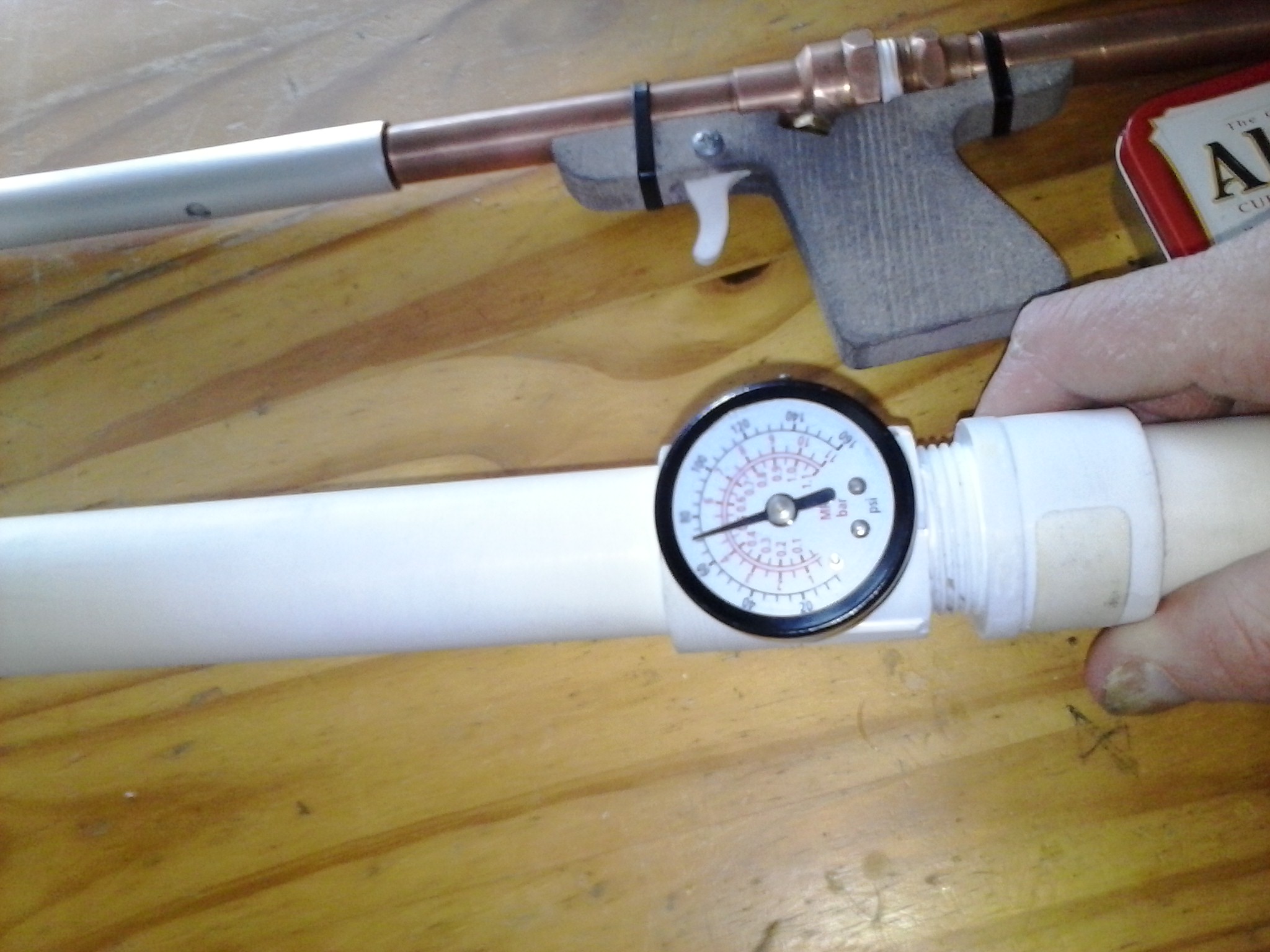

Well here it is ! Three 12" brass .30 caliber tubes in a foot long 1" chamber. Pump handle needs work, but pumps great without drawing a vacuum. A magnetic shot retainer for steel shot. Did I mention it's portable and self-contained, hehe! :D

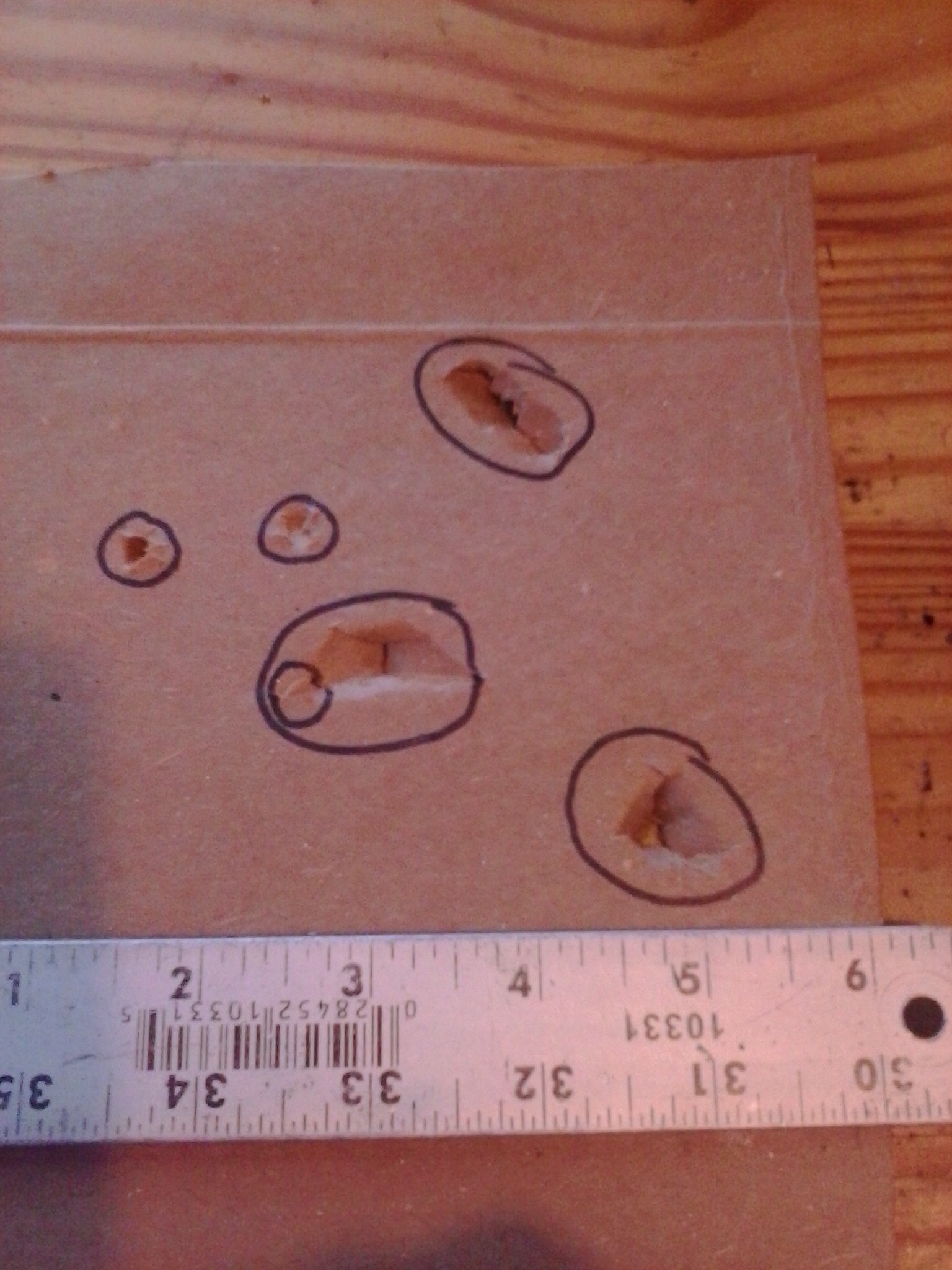

Best I can show today is a four shot group , only one shot of the four spread out about
1.5" . I think thats almost too tight , however I was only 15 feet away. :D
I think at 30 feet it will pattern nicely!
Sweet. What pressures do you reckon you're generating? A small pressure gauge would be a cheap and easy addition to the chamber.

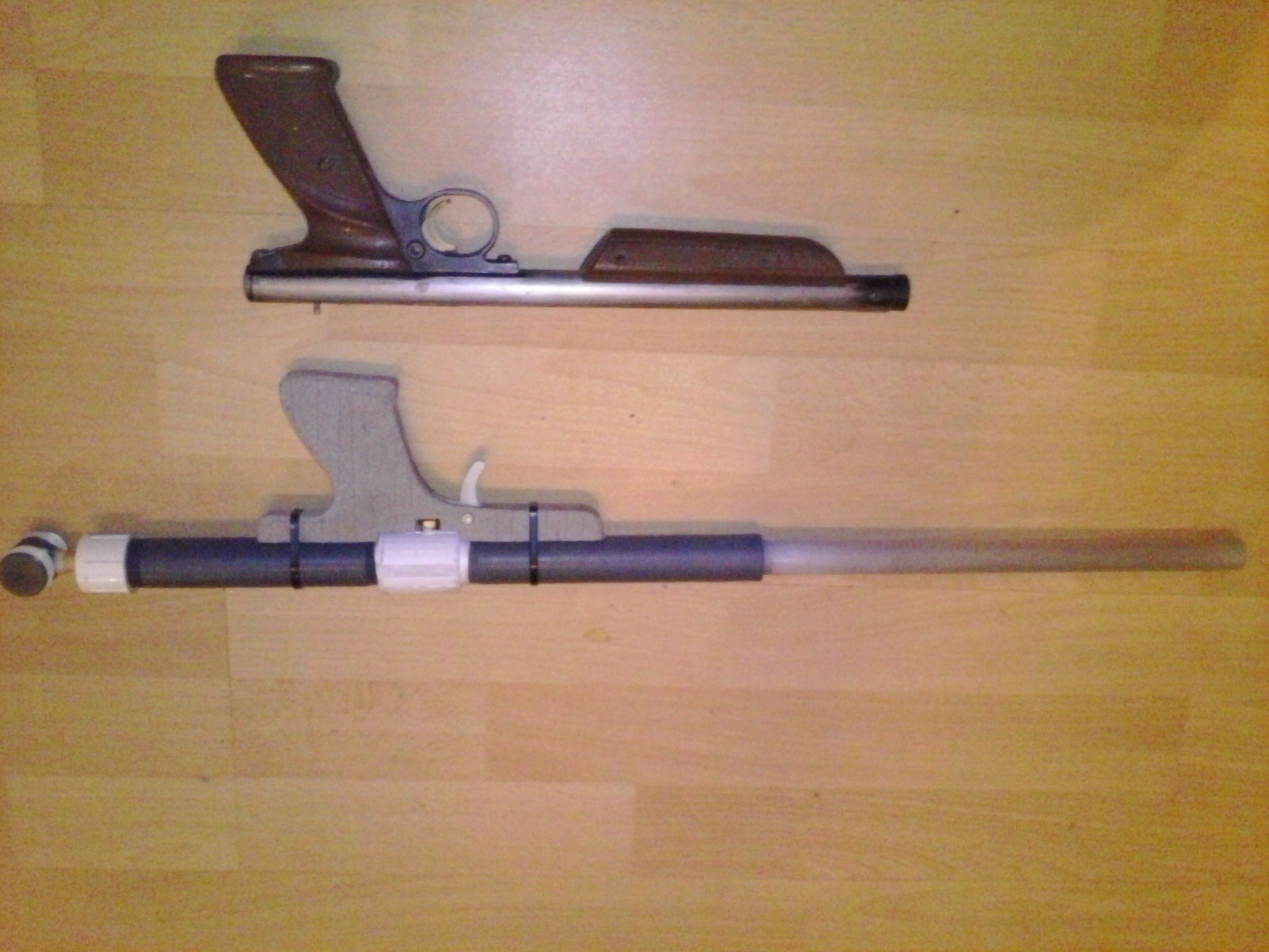

@jack- Well this pump is the largest diameter I've made with the piston at 1" o.d. ( I use 3/4" or 1/2" normally ) because i wanted lots of air. Every stroke of this size puts 15 psi it seems so the limiting factor is your comfort and saftey. Six pumps hit the 70 psi mark on the gauge , I can do nine pumps before having to put it on my foot for leverage. Of course I respect the limits of pvc.
The pistol in the photo is my first prototype grip and trigger designed to fit all my other guns. Its engineered wood and pcv.

dajoro wrote:Well this pump is the largest diameter I've made with the piston at 1" o.d. ( I use 3/4" or 1/2" normally ) because i wanted lots of air. Every stroke of this size puts 15 psi it seems so the limiting factor is your comfort and saftey. Six pumps hit the 70 psi mark on the gauge , I can do nine pumps before having to put it on my foot for leverage. Of course I respect the limits of pvc.
Not bad! Though for a given quantity of air, high pressure low volume gives more power than low pressure high volume. Small bore pumps and metal construction is the way to go if power is what you're after.

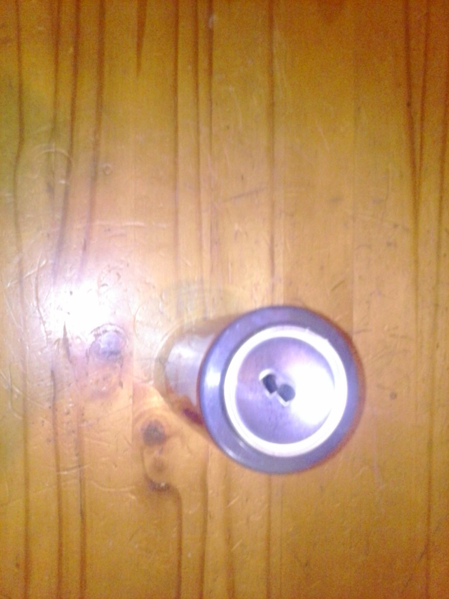

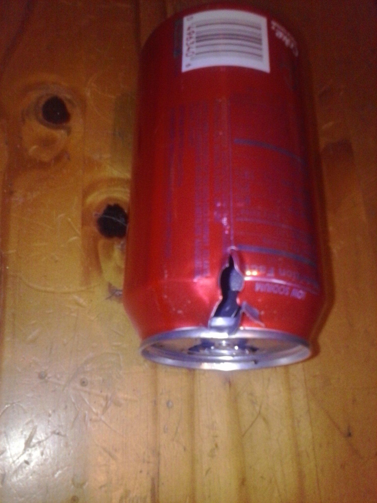

NICE LINK ! The internal diagrams of the trigger mechanism I have not seen before. Lots of ideas there . I'm working toward high pressure with as few pump strokes as possible , in single shot for now. This model gets 110 psi. in five strokes in a .25 caliber, enough to punch the bottom of a coke can and out the side at 20' .

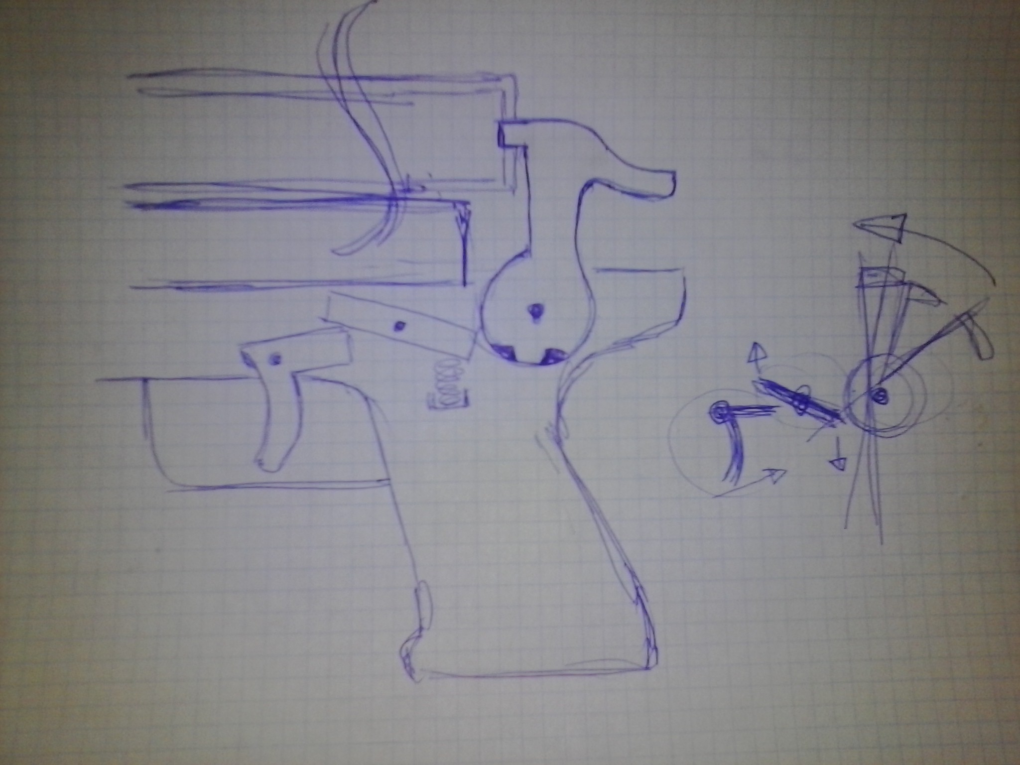

I tried fixing the first photo with no luck...
dajoro
Posts: 40
Joined: Thu Aug 01, 2013 3:26 pm
I have edited my last post due to embarrasment . It was apparent when modeled from cardboard , I had the sear catching the hammer the wrong way! So I left the photo for amusement, lesson learned.
