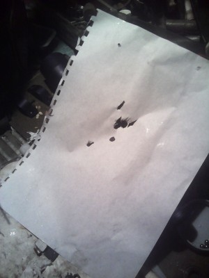

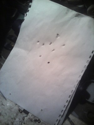

maybe someone dig deeper into accuracy and knows more than i do. Again i got accuracy issues, large issues.
TO 7 m i put the bb in same hole every shoot, but when i shoot to 25 m the bb hit somewhere else . I set the scope there but next shoot again someplace else. I test it all day long.....few hundred shoots........ I tried another scope, i checked the barrel to be streight few times. Changed the power. THe bb enters perfectly into the barrel from the breach loading. The barrel is inside other 2 pips so it is solid. Nothing moves. BBs are umarex steel, barrel is airsoft steel..
I dont know what is wrong cuz some time ago it was shooting very well to 40 m or far.
YOu know the satisfaction to hit where you want by one shoot.
tasco scope
tasco scope
buschnell scope
buschnell scope

A little more info would be helpful, in particular, the valve mechanism. Shot to shot variance in power would not only produce a difference in elevation between shots, but also in windage due to the way a BB travels down a barrel which isn't perfect and through the air.
bravootome
Romania
Posts: 334
1st picture is with a tasco scope.
1nd picture is with a buschnell scope.
Both are cheap scopes........

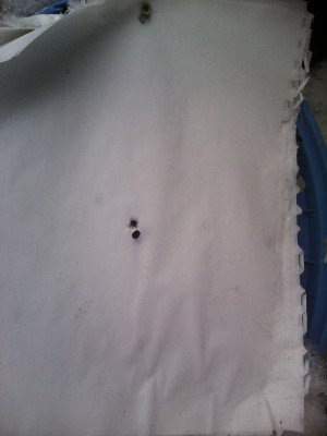

Edit :
1. fixed inside the scope
2. shorten and recrowning the barrel
3. removing a screw used to fix the barrel on th gun. It was strangling.
leaning the barrel after each 3 shoots.
The shoot is by 28-30 m
30 m shoot
30 m shoot
