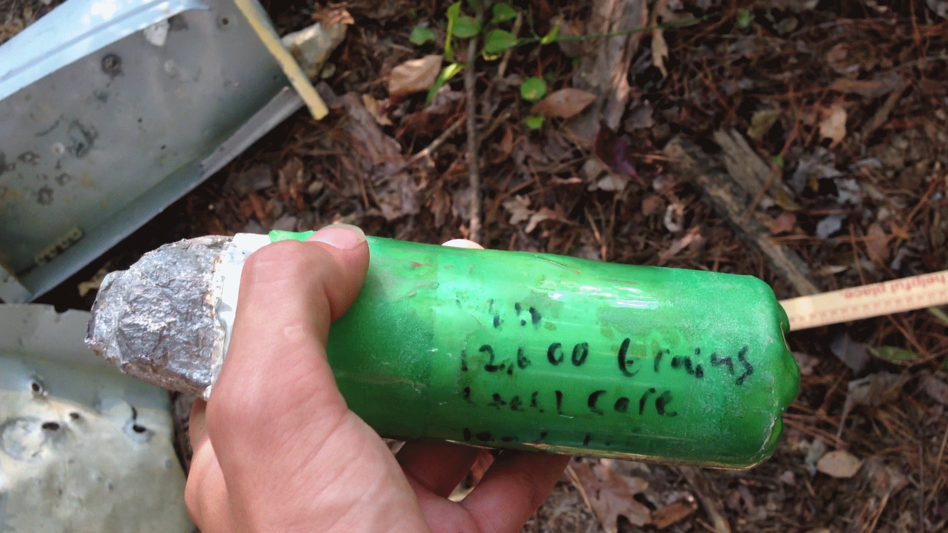

I decided a little while ago that I would push the envelop a bit and see exactly how heavy of a round I could shoot out of my larger air cannon. It turns out what I ended up making was probably the heaviest bullet I could make weighing 12,600 grains or 1.8 pounds. The round consist of a mild steel or cast iron core (I'm not sure which), a lead tip, plastic jacket with a layer of aluminum underneath it and then a filler under that. We ended up shooting it a 1/8 steel plates and solid 4 in thick cinder blocks. I have a HS camera and we decided to try and figure out about how fast it was going. From what I can tell it was just going to slow at only around 120 FPS but had enough mass to give us a calculated energy of about 400 foot pounds and I think it was just going to slow do much of any damage to the plates or blocks.
check out the video of the round being shot:
Is 12,600 grains (1.8 Lb) to heavy for air cannon ammo?

I was shooting it out of my larger cannon that has a recoil system and it had no problem handling it but it was able to fully extend the 2 50 Lb springs providing resistance. I haven't bothered to see how fast it can get lighter projectiles going but I would guess mine would be able to get a 1/2 pound projectile going upwards of 400 FPS.Ragnarok wrote:Depends on exactly what you want from it.
