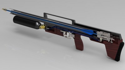

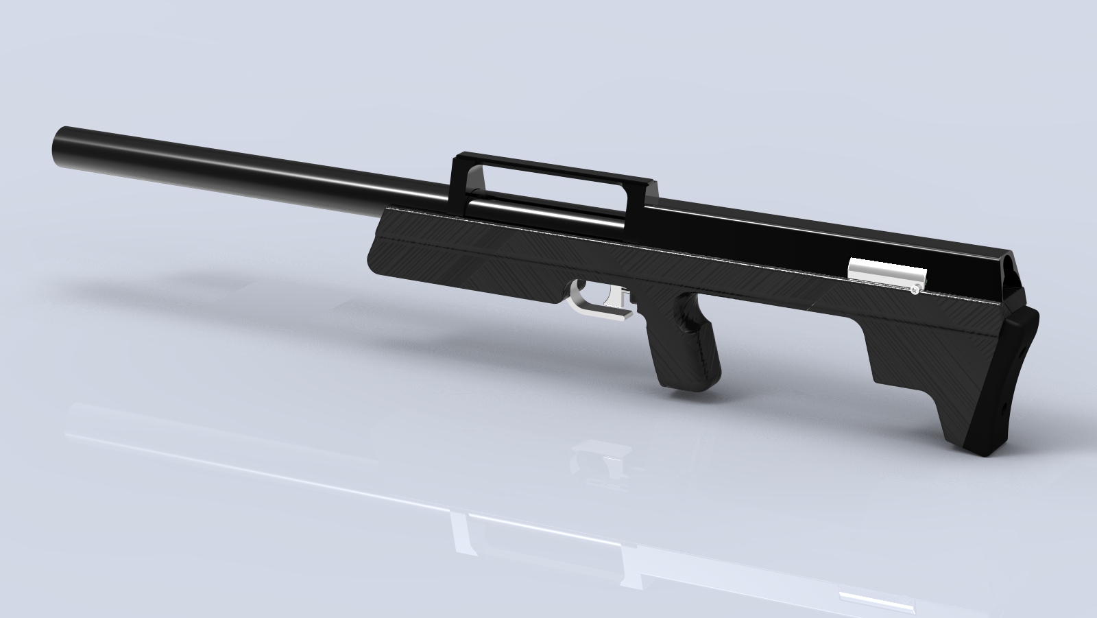

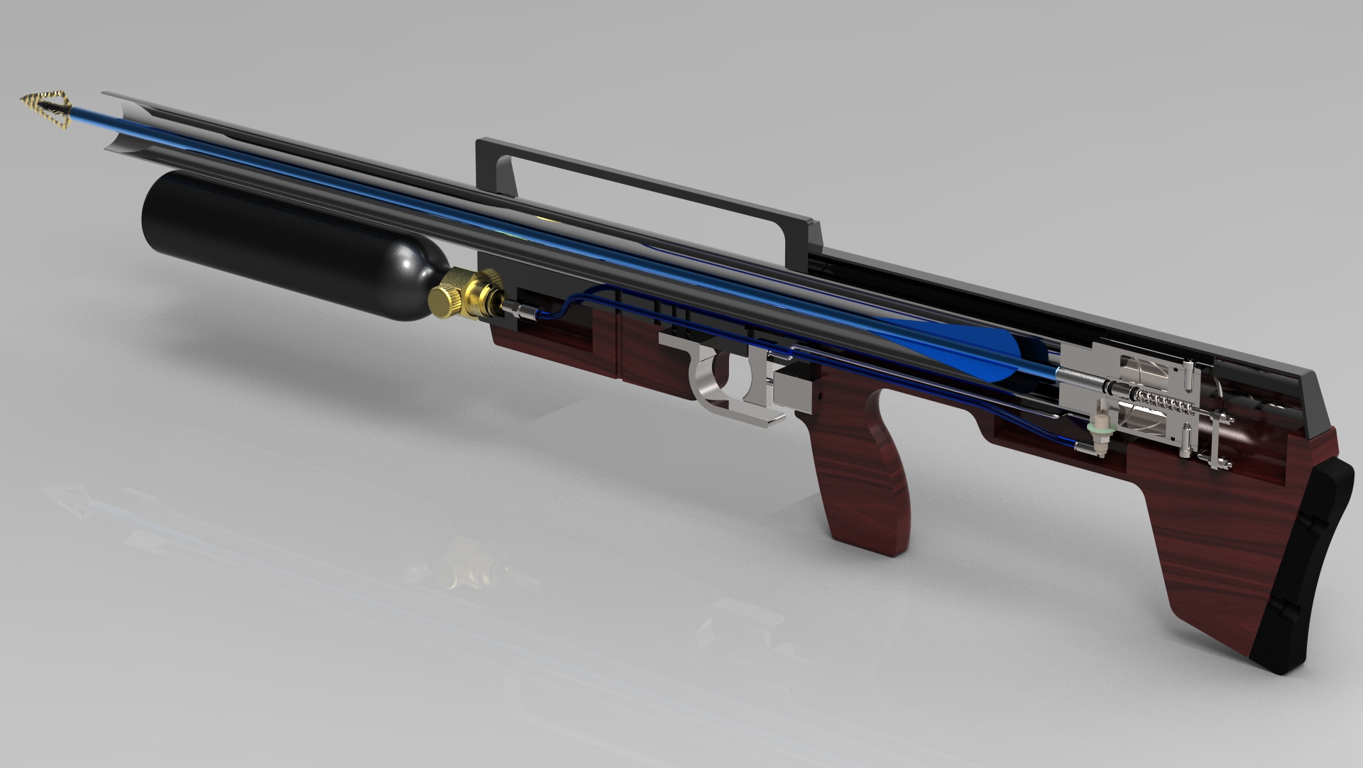

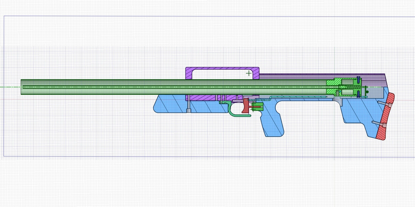

Still trying to make heads or tails of that first drawing... Where is the chamber? Is it that little area behind the arrow? Or does it not technically have a chamber, and instead the valve is essentially dumping just the air in the line between the tank and valve? And then your 'barrel' actually fits inside the arrow? (the tube around it is essentially just for show?)
To the point: what volume are you working with as the chamber?
edit: I think I've got it - the small area behind the barrel is the chamber, released via a manual valve (push rod from the trigger). The barrel is actually inside the arrow, while the tube around it is just looks/safety.
You have the workings right sharpshooter. The shroud is there to protect the barrel and it looks neater too,in my opinion. There is 2.8 "cu co2 in the valve but it looks like I may have to increase that. Although it's a work in progress, here is a rendering of the launcher further along in its design.
