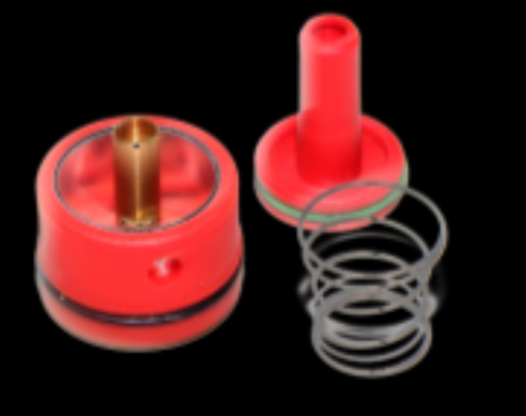

There's a vid animation on YouTube showing a AEG gearbox with a blowforward nozzle.
I found this pic of discontinued part.
Interested in thoughts why think they stopped making it. /discontinued.
Or if anyone knows why not good in AEG gearbox.
Blow forward AEG nozzle... Why it didn't take on?
Probably lack of power. Blow forward valves work well but since they need to be activated before the shot is fired, they lower gas pressure significantly meaning there is less pressure available to actually accelerate the projectile.Doc j wrote: Fri Jun 12, 2020 6:07 amInterested in thoughts why think they stopped making it. /discontinued.
With a blowback mechanism on the other hand, the projectile can be out of the barrel before the bolt moves significantly, meaning that most of the gas used would have been "wasted" anyway.
