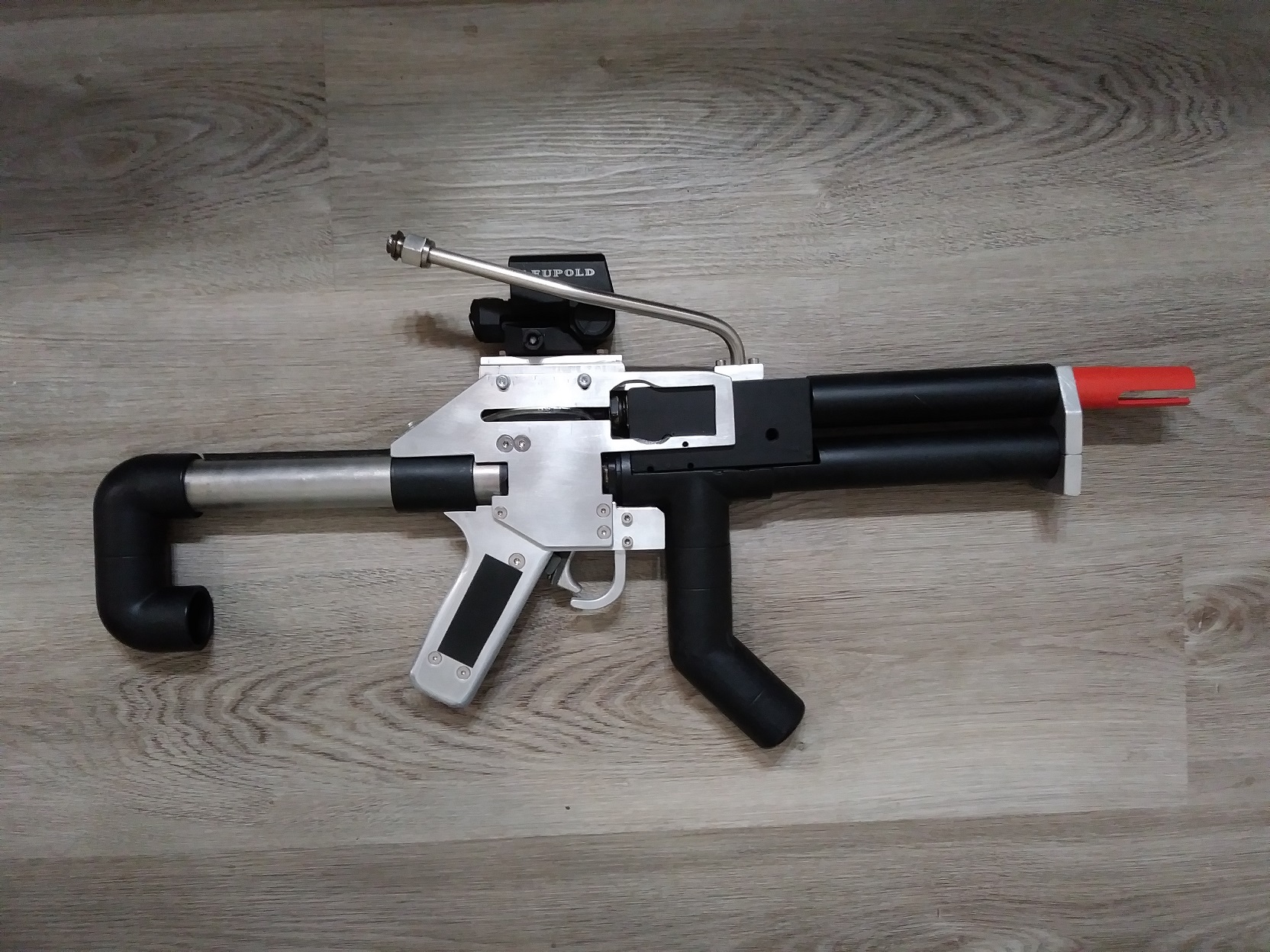

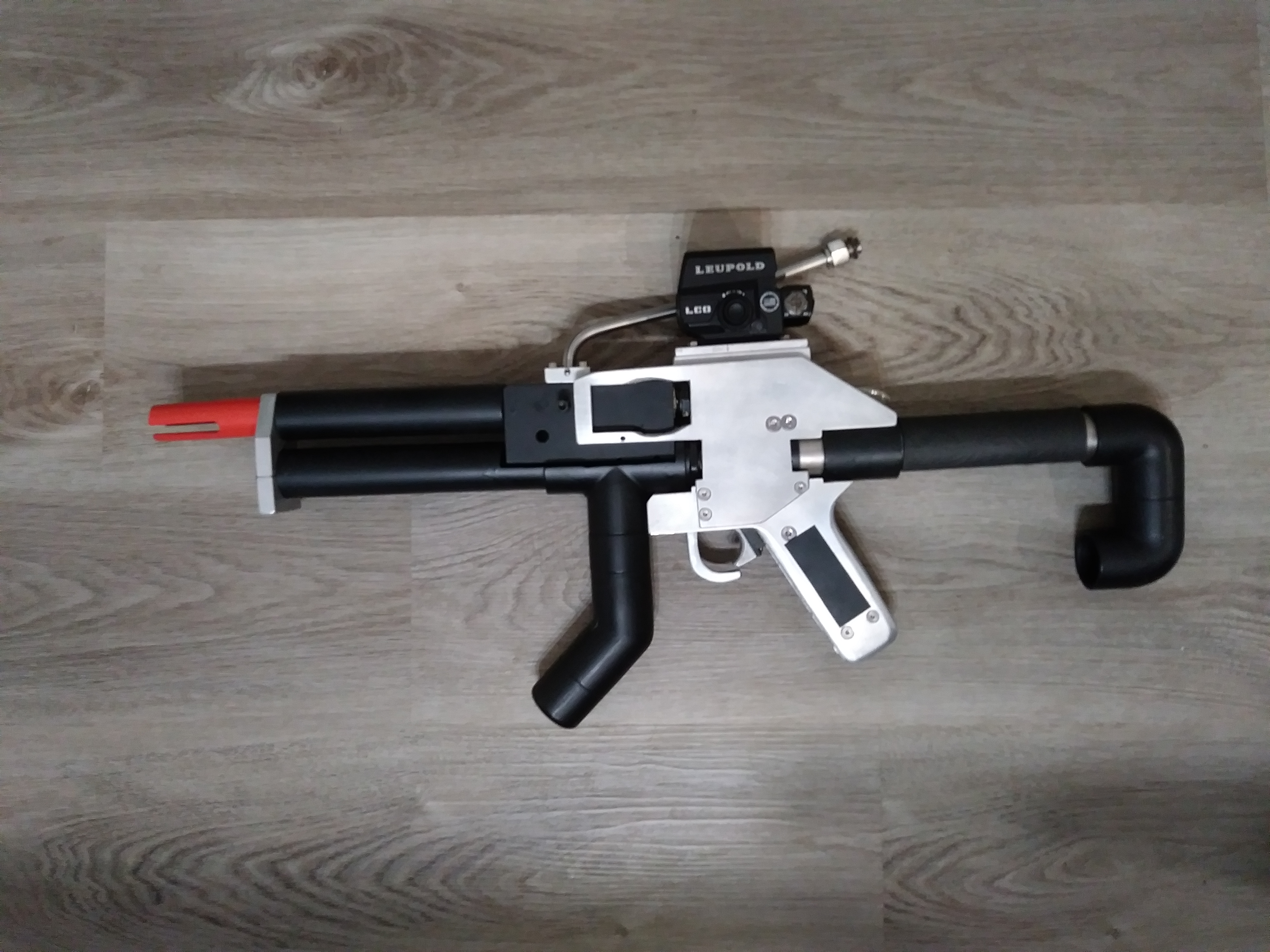

I built it into my single shot airsoft

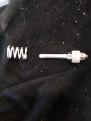

Made the piston from a 6mm bolt and a piece of nylon
The blow forward bolt definitely works and is relatively easy to build:
