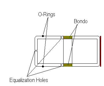

So, what do you suggest for the size of the equalization hole? I made my piston out of two 1-1/4" end caps, so would I just drill one hole in the back and a few on the sides?
- Diagram of where I want to put the equalization holes.
- piston.GIF (3.75 KiB) Viewed 2033 times

First, I assume this is a barrel-sealing piston, not a chamber-sealing?
If so, you want to drill the equalization hole near the outside edge of the piston - where the piston surface is exposed to the chamber, not the barrel. Otherwise, air would leak out the barrel.
I don't think you need a very big hole. Maybe 1/16th" or so? Start with that and drill it out larger if need be... External equalization is another option, too.
