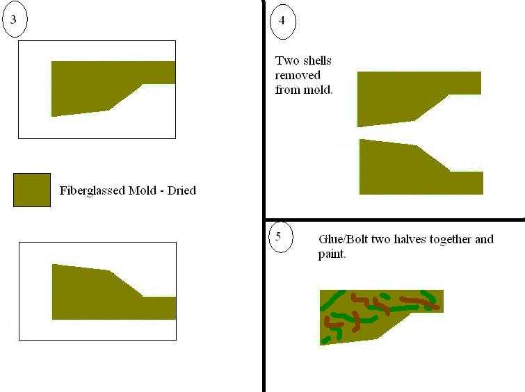

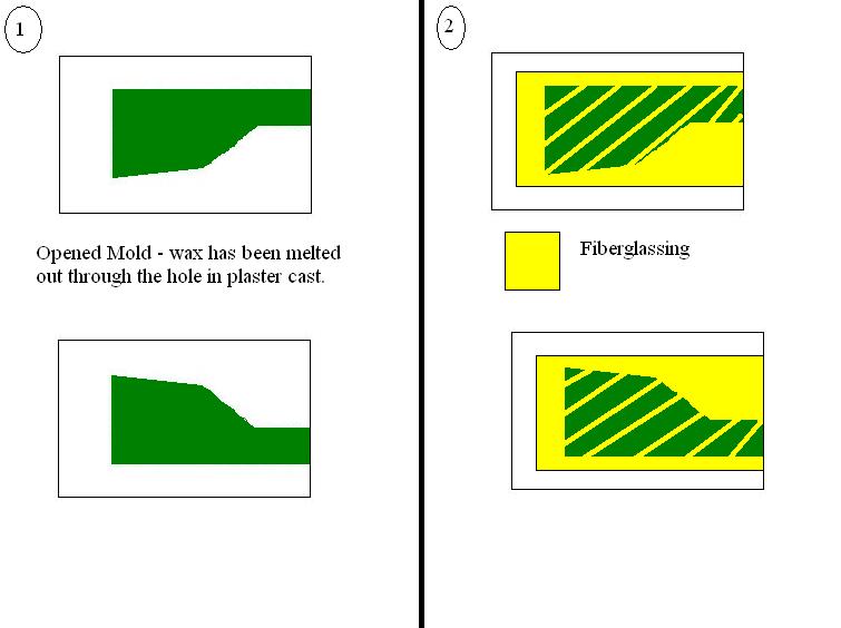

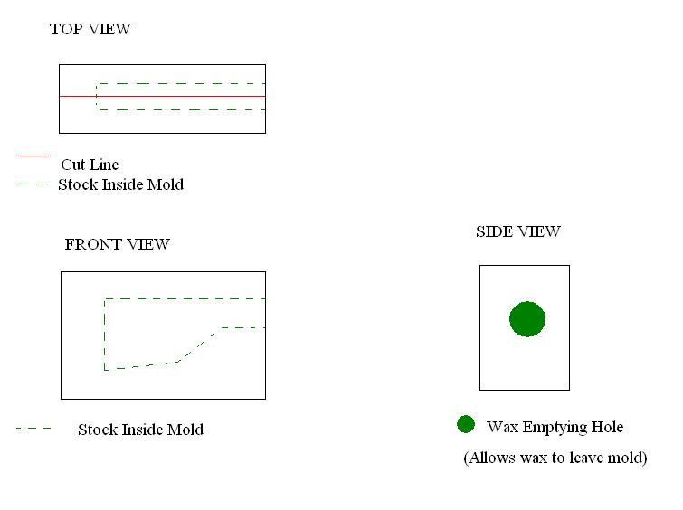

Why not stop at the part before you fill the mold, and instead melt the wax and split the mold in-half lengthwise/vertically (so that you have two identical halves when opened. After you opened it, you use fiberglass to make two halves of the mold and glue/bolt them together.
Orthographic View of Mold.
Step 1. Open mold after melting wax out.<br />Step 2. Fiberglass two halves.
Step 3. Wait for fiberglass to dry.<br />Step 4. Remove the two shells from mold.<br />Step 5. Glue/Bolt halves together.
