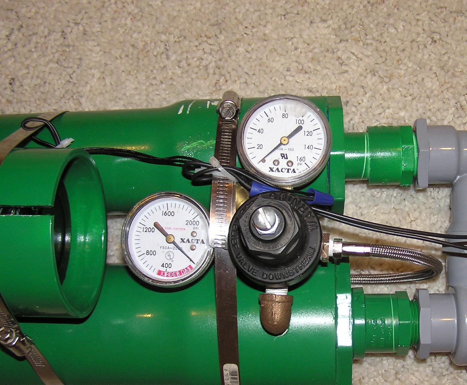

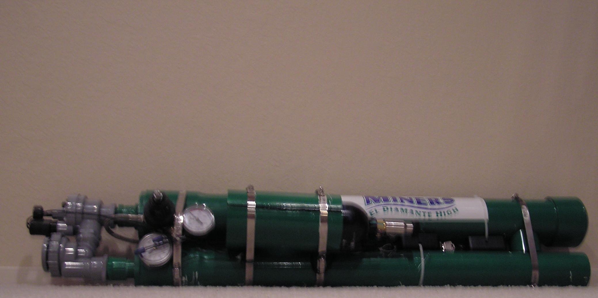

turbohacker
Posts: 392
Dont use copper it's only rated to 800 psi (give or take a little) A full CO2 tank has about 1500-1600 psi, without a regulator their could be a slight problom. Use one like the one I used on my gun, it alot cheaper :)
Heres my entire gun
Heres my entire gun
Beer Keg regulator
Beer Keg regulator
