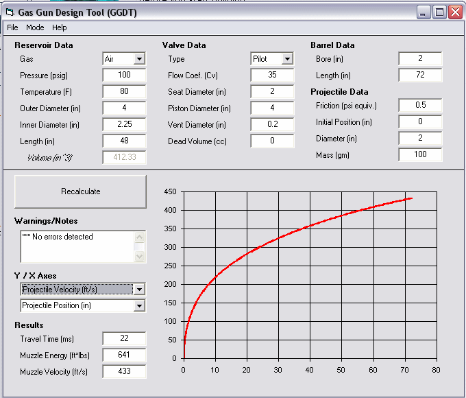

hey guys, pyro and I are going to build a 4 inch coaxial with a 2inch barrel later on today. what kind of performance do you think we are going to be getting? with a cauk tube.
thanks i cant use ggt or whatever its called.
if you can give us the full dimensions, pressure you intend to use and weight of the caulk tube i'm sure we can give you an idea.
Why can't you use GGDT? You should try, it's a real gem of a program and saves you a lot of trial and error playing with variables before you start building.

ok, 4 feet of 4inch for the chamber, 6 ft of 2inch for the barrel, 100 psi, and i dont know the weight of the tube as i dont have any at the moment.
i cant use ggdt because i have a mac without exel
here's a rough estimate with a 100 gram projectile

thanks, thats just what i needed
Interesting to note that that predicted muzzle energy is roughly twice that of a 9mm pistol round :shock:

Twice the muzzle energy as a 9mm pistol round...wow...

rna_duelers wrote:Twice the muzzle energy as a 9mm pistol round...wow...
It gets better, with a 2 inch steel ball as ammunition, the energy is about 100 ft/lbs greater than a 0.44 magnum round :D

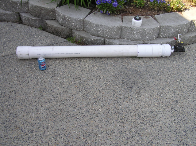

It works great!!!

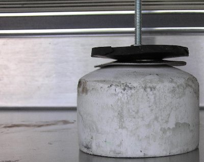

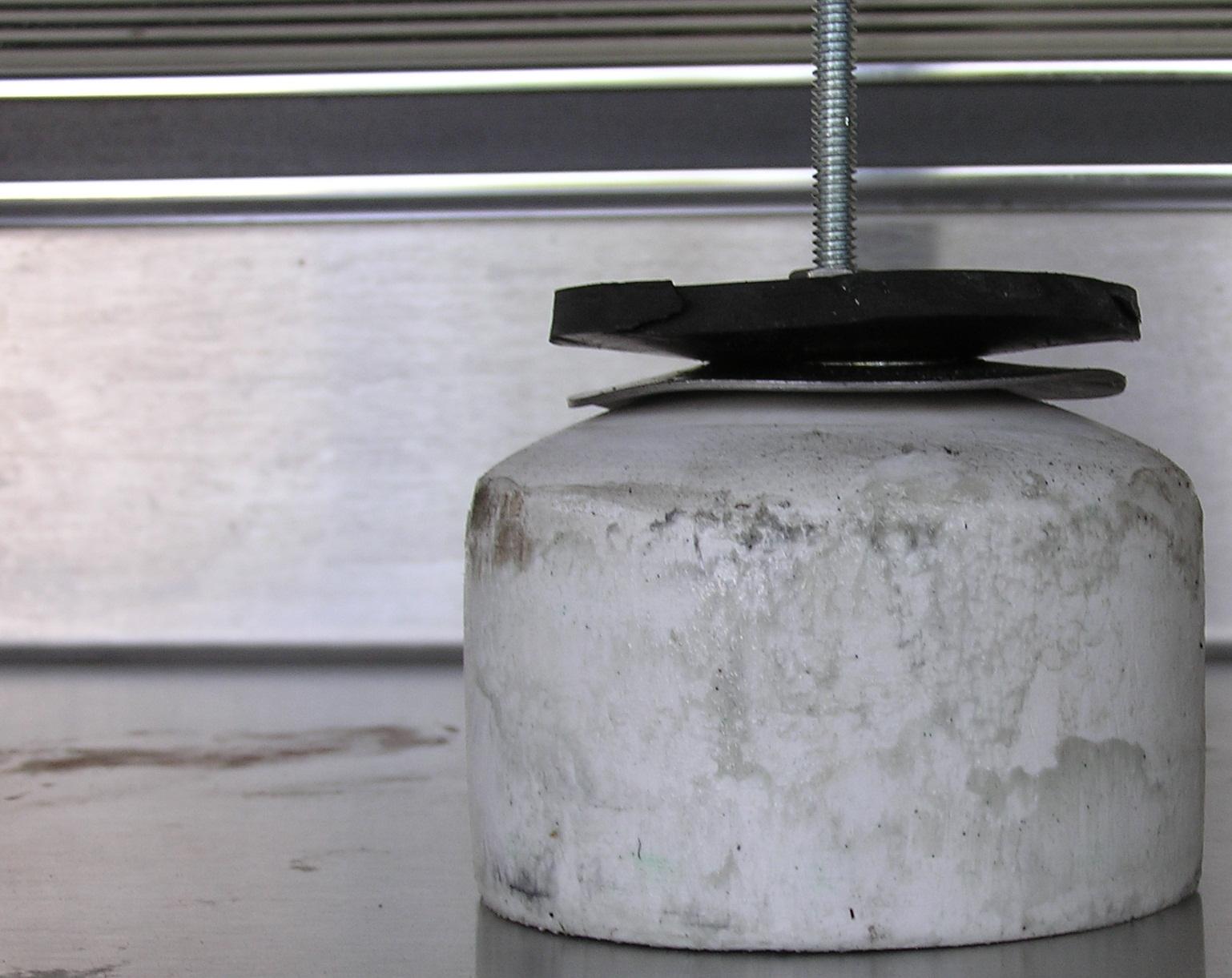

I reccomend using a slightly filed 3"cap as your piston as seen on my gun.

turbo, i just checked out your coaxial. I love the flanges ( or whatever they are called) how long did the sanded cap take? I only have a drill and a dremmle
edit: to avoid confusion, I meant pyromaniac not pyro. too many pyro names....
edit edit: sorry didnt see your pics. thought you meant the green gun
turbohacker
Posts: 392
Yeah, i just drilled the hole for the bolt dead center and mounted it in my drill press. I then ground and fit a few times with an angle grinder with a flapper wheel. A drill mounted in a vise would probobly work just as well...

Ahh yes an 3"endcap,fill it with space filling foam or similar to reduce the pilot volume.Haha I wouldn't shoot something like that in town or a city thats a little crazy and could see something bad happening..
