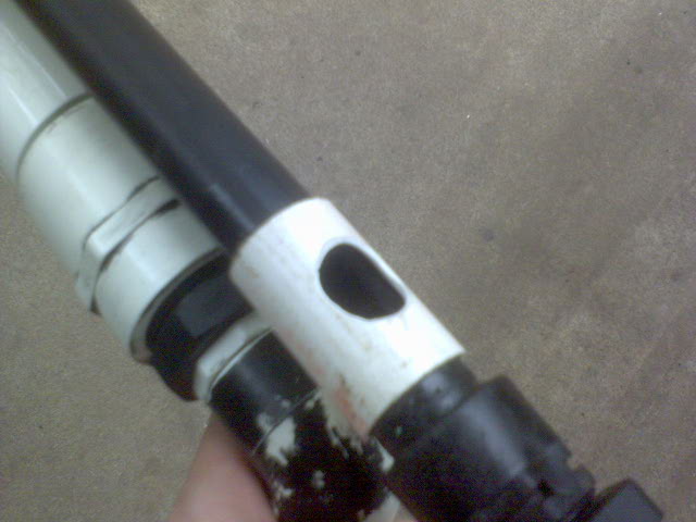

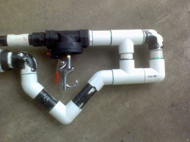

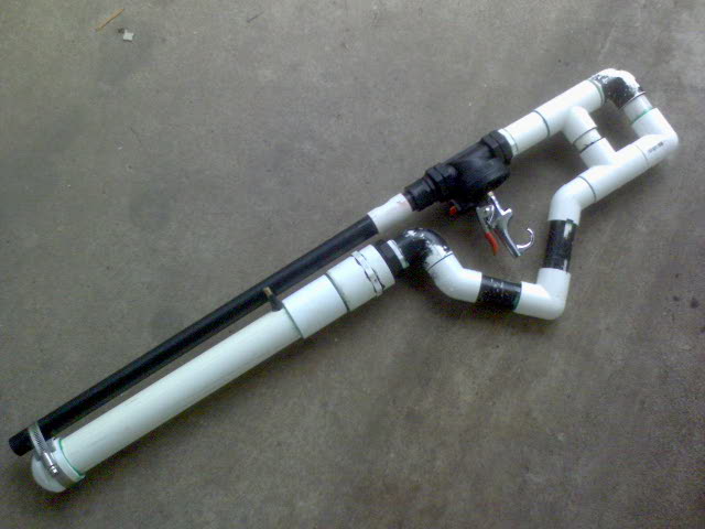

i made this gun at about 3 this morning (Christmas eve) it has a revolving breech load and my first ever MODED SOLENOID
i haven’t been able to test it yet because my bike pump broke a couple of days ago
plz leave ur coments

Nice man, These are heaps of fun.

Indeed it is nice.I finnaly see pictures of the finished product.Let me no if the modding design I showed you works well or not.

Thats a little like my gun. See if you notice the extra performance with the modded valve. It makes a big difference.

marbles with a bit of chucks around them

Looks great! I'm guessing the barrel is 3/4" SCH-80? Find you some half-inch low-pressure, (type M), copper tubing if you wanna shoot marbles a little better. Just use a 5/8" OD compression x 1/2" NPT adapter to connect. This gives the barrel a little squeeze at the back to stop the marbles, (if you tighten it all the way). BTW, you have to use a ram-rod to load marbles this way! That's how good the fit is.

You should try fishing ball thingys thta you tie to your fishing line, they fit great in 3/4" pipe and are bloody destructive.
