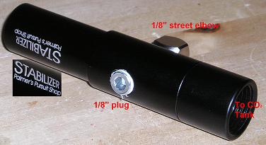

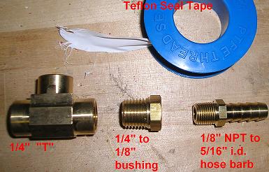

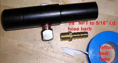

self explaining, the regulator is http://www.palmer-pursuit.com/online-ca ... female.htm
http://www.spudfiles.com/uploader/uploa ... egfmod.jpg
http://www.spudfiles.com/uploader/uploa ... egbmod.jpg

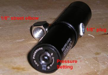

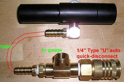

http://www.spudfiles.com/uploader/uploadFiles/barb1.jpg
http://www.spudfiles.com/uploader/uploadFiles/barb2.jpg
