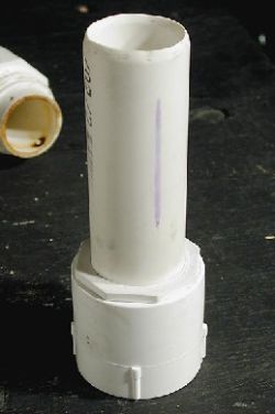

An Aluminum Spud Cutter
A PVC Slug Cutter
