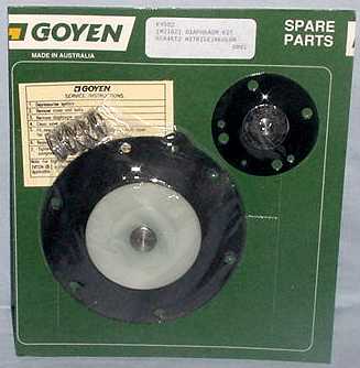

this is matties, but i have the same valve
mattyzip77 wrote:pic added hope its "suitable" and appropriate............... :thumbright: :thumbright: :thumbright:
look at the middle one, , that little plastic piece my valve didnt come with it,, im trying to figure out something very strong to seat correctly and seal

jsefcik wrote: look at the middle one, , that little plastic piece my valve didnt come with it,, im trying to figure out something very strong to seat correctly and seal
The diaphragm is Buna Nitrile/Nylon PA6. Kit number K4502.

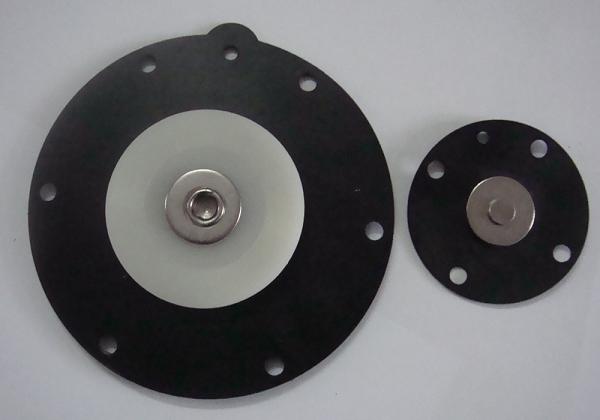

Here is another variation:
http://www.ebay.com/itm/3916-Goyen-Hytr ... 2934955%26
