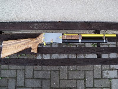

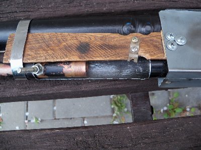

This is my 5.5 mm pellet air gun i made last summer. The paint wear off a bit, need a new paint job :cry: . It runs on 100-120 psi, QDV valve, PVC air chamber. Has a lot off power, pellets easily penetrates through cans and other stuff. This is my second build. I'm really happy about it :D Making a wooden foregrip (Brian the brain thanks for advise).
So how is it?
Video:
Old look
Old look

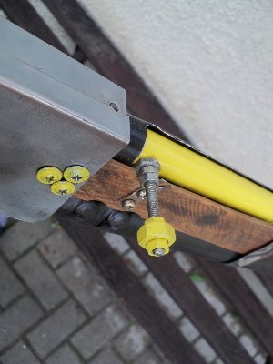

Fancy bolt :D listening to advice

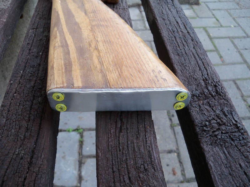

Added metal plate on the back off the stock

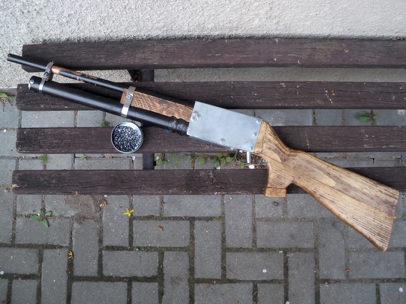

New look
New look

Thats a nice gun
Sun May 12, 2013 6:13 am
Don't paint it, I love the look!reminds me of the BAR :) fantastic.

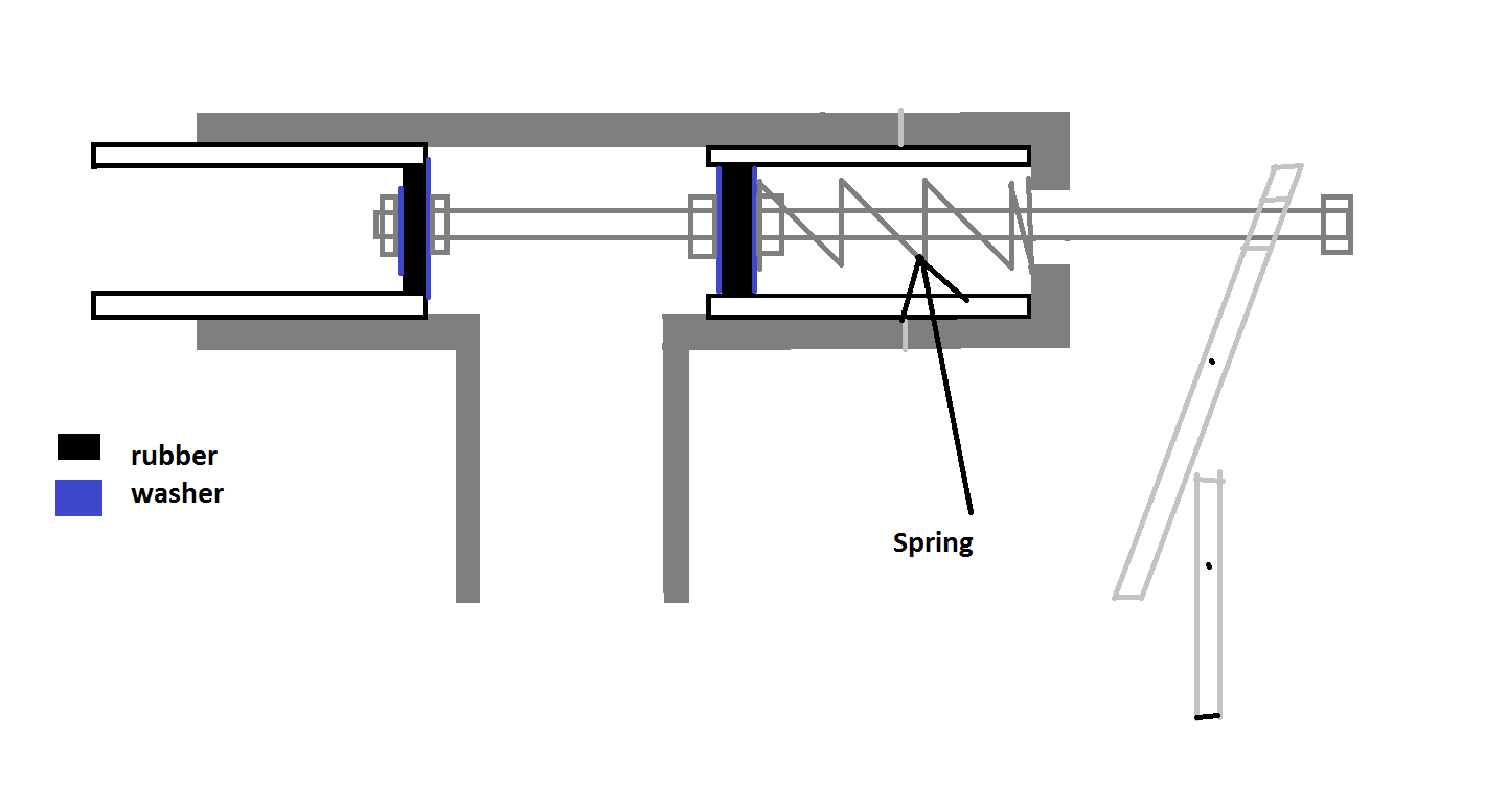

jackssmirkingrevenge http://www.spudfiles.com/forums/paca-mk ... 21703.html in fact this is exactly where i found the valve design. But i modified it a bit: placed a spring in it and made a different trigger mechanism with a lever.

Added a diagram of the valve.
Loading mechanism is very simple you will see it how it works in the picture.

Loading mechanism barrel slides front when i move the bolt
Valve
Valve
Tue May 14, 2013 12:24 am
ignatorius wrote:Thanks for compliments.
Simple but effective, nice :) You dump all the air for each shot though right?
