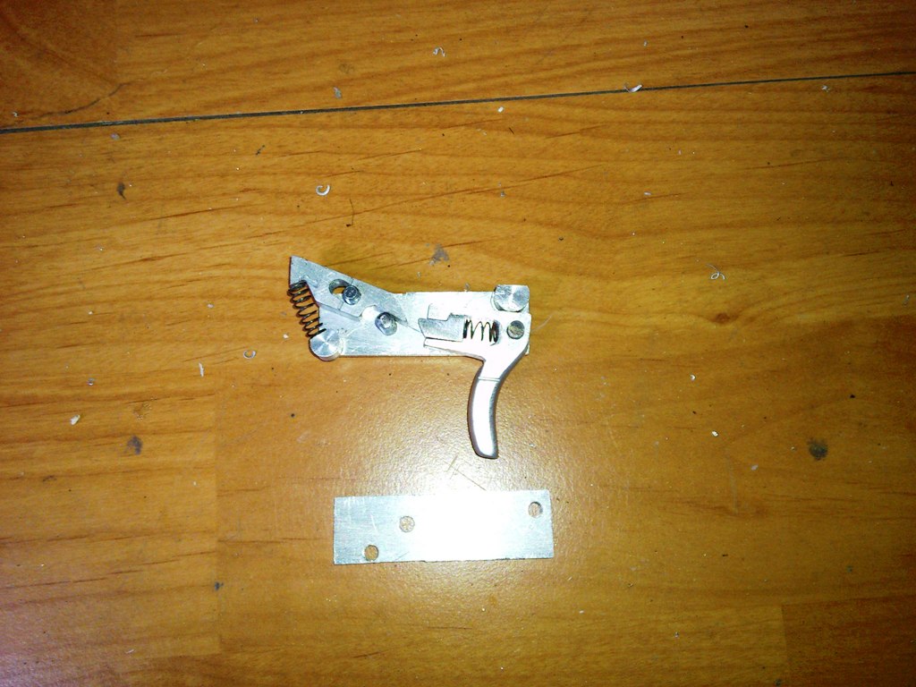

I wanted t know if it's possible to use a hammer valve to archive by having the air re-cocking the hammer while firing a airsoft bb.
I studied some airsoft GBB guns, most of them follows the design of WA magna system
It's a simple system, but a large portion of the propellant is wasted. So I went for a different approach with a design that was attempted by numerous people but I haven't found one that made it work yet. Theory it's simple, having a hammer hit the valve opening it, the air fires the projectile while also pushes back the hammer, re-cocking it. In this design the air that's used to re-cock the hammer ends up exiting from the barrel as well so in theoretically no wast also easier to suppress. It's simpler for me to make the trigger but require a much more precise valve and hammer, also the pressure inside the chamber and various springs with correct length and strength.
I did several GGDT simulation to get an idea of hammer weight, travel distance (which also gives me the volume of air I needed to re-cock the hammer), hammer force (spring strength, weak enough for the air to push it, yet strong enough to open the valve to give the correct amount of air) and most important , barrel pressure. Then all left to do it's find the balance between force needed to open the valve, hammer strength and result barrel pressure.
In the worst case, considering dead volume as hammer travel*area, using a .2g 6mm bb (actually varies from 5.99 to 5.98 mm), 6.1mm barrel, the barrel pressure it's 1.6 bar, hope with a hop up (airtight detente) I may get a little more. So far with 1.6 bar should be enough.

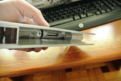

For now I have finished all the tricky parts: trigger, valve and airtight hammer with spring.

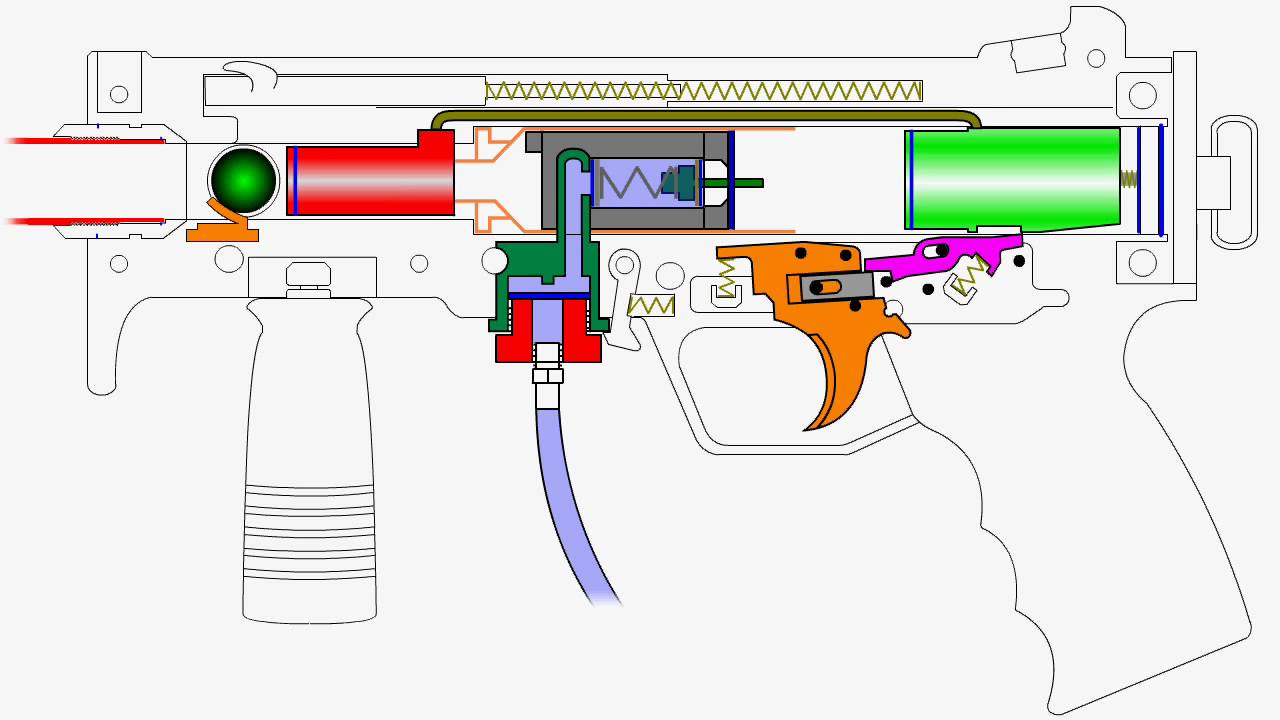

Am I correct in guessing your going for a layout similar to what you find in tippmann paintball guns, what with a centrally located valve, hammer hits valve, hammer pushed back,gas flows around the inline valve unit, etc?
something like this:

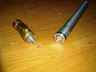

Finished the valve, I machined it from a solid aluminium cylinder
The valve stem is probably the most tricky thing I've made so far
but with the help of some homemade HSS tools it turned out really well

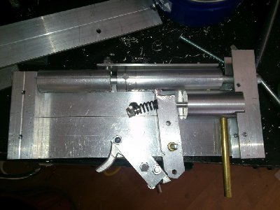

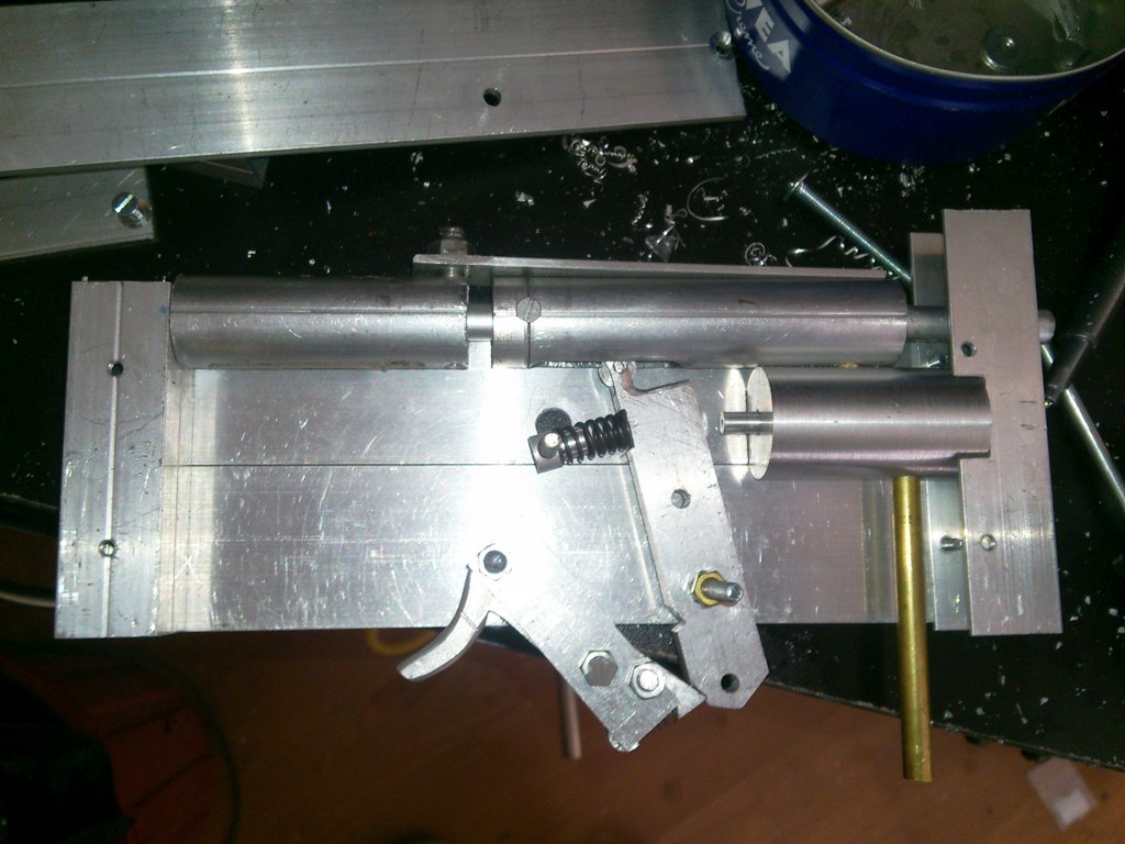

Epoxyed the valve with blow-back cylinder, hammer locking mechanism finished, roughly shaped the hammer which already works
All left are actually just some holes to drill and mount everything

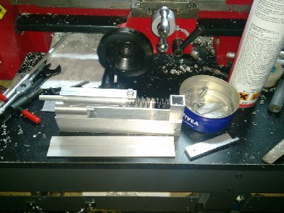

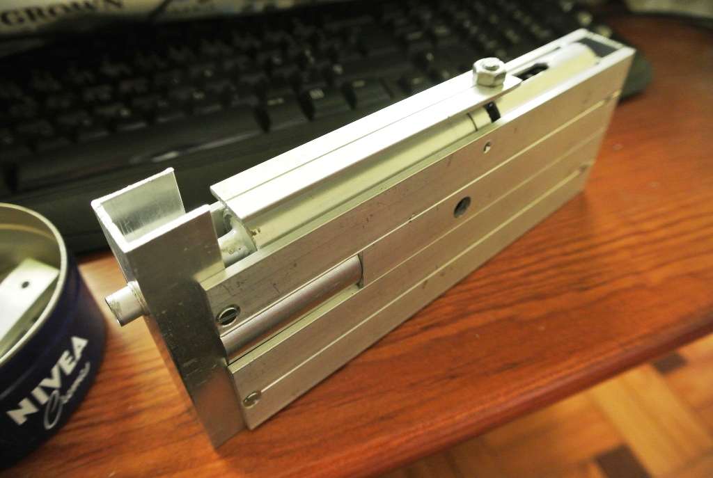

Finished the housing, now just missing some holes to mount the pieces of trigger and hammer
Edit: made some adjustments on the piston length, burst the power a little
Also will favor the return spring life span.

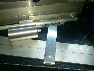

Finished the hammer and lock.
Tested, worked at pressure as low as 50 psi. past through 100 psi the piston opens as a bang also travels back way further than I thought. Hammer is re-cocked reliably, however I'll take the advantage of the extra piston travel to use a weak spring but longer for a smoother operation.
