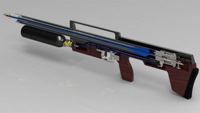

I have been designing a pneumatic arrow launcher and have a question I am hoping someone will be willing to answer. The design is not complete but I am getting there.
Firstly, the arrow gun uses a QDV. Credit for inspiration must go to Technician 1002 and Auxiliary.
Here is my question. When determining fps and muzzle energy is there a benefit to the fact that the arrow fits outside the barrel? When using Ggdt (thanks to D. Hall) to determine the mentioned figures, does the arrow shaft, as the arrow moves along the barrel, act as an extension to the barrel length? So if I have a 30" barrel and a 31" arrow, will the max fps and ft*lb be determined by a 30" barrel or by a 61" barrel.
While researching, I read in two places, that the shaft acts as a barrel extension until it leaves the tip of the barrel but I can't get my head around that.

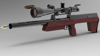

very nice design

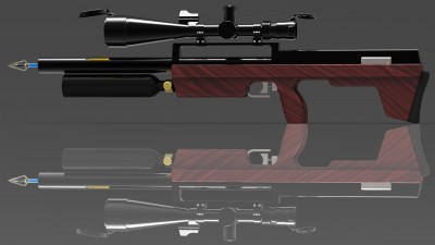

That would be sweet as a pellet or BB gun as well, put a scope on top and I would be really excited
						I went to a paintball shop yesterday and found out about remote lines and pneumatic fittings. So the above is meant to be run off a remote line. At the same time I would like to see if I can fit a 9oz bottle ahead of the trigger and have a microline running to the valve. I would be ok with having it tethered but I think many would prefer a CO2 bottle on the laucher instead.

Alanstone wrote:Do you mean something like this?
NICE :bounce:

The shaft doesn't really act as an "extension". The acceleration still occurs for the length of the barrel since when the base clears the "muzzle" it unseals and pressure drops.
Design looks good, although some labeling could make things a little clearer. Now just to get pictures instead of ray tracings.

I would think actually that the shaft just creates a larger 'dead space' area - as the entire barrel is empty in the beginning - and the volume only increases to approximately 2x that dead space up to the point of arrow leaving the barrel. This would create a softer acceleration curve - which may be beneficial in closer replicating that of a bow's effect with the string (thinking more along the lines of recurve, compound bows probably have funky acceleration curves but I'm sure companies like Mathews/hoyt/etc. have those curves precisely calculated!). Only reason I mention that is I know harmonics can play an effect on an arrow - based on my armchair engineering experience of watching bow's launch arrows in slow-mo on youtube
So back to your GGDT question for modeling - use the barrels volume as a 'dead space' value - and you can stick with the barrel length as the actual barrel length - diameter would be the inside diameter of the arrow shaft, not the barrel itself. That's my understanding of the problem - others may have a better suggestion.
Awesome layout and render BTW! I like the bullpup design execution!
Much water needs to flow under the bridge before we get to photographs!Now just to get pictures instead of ray tracings - mark.f

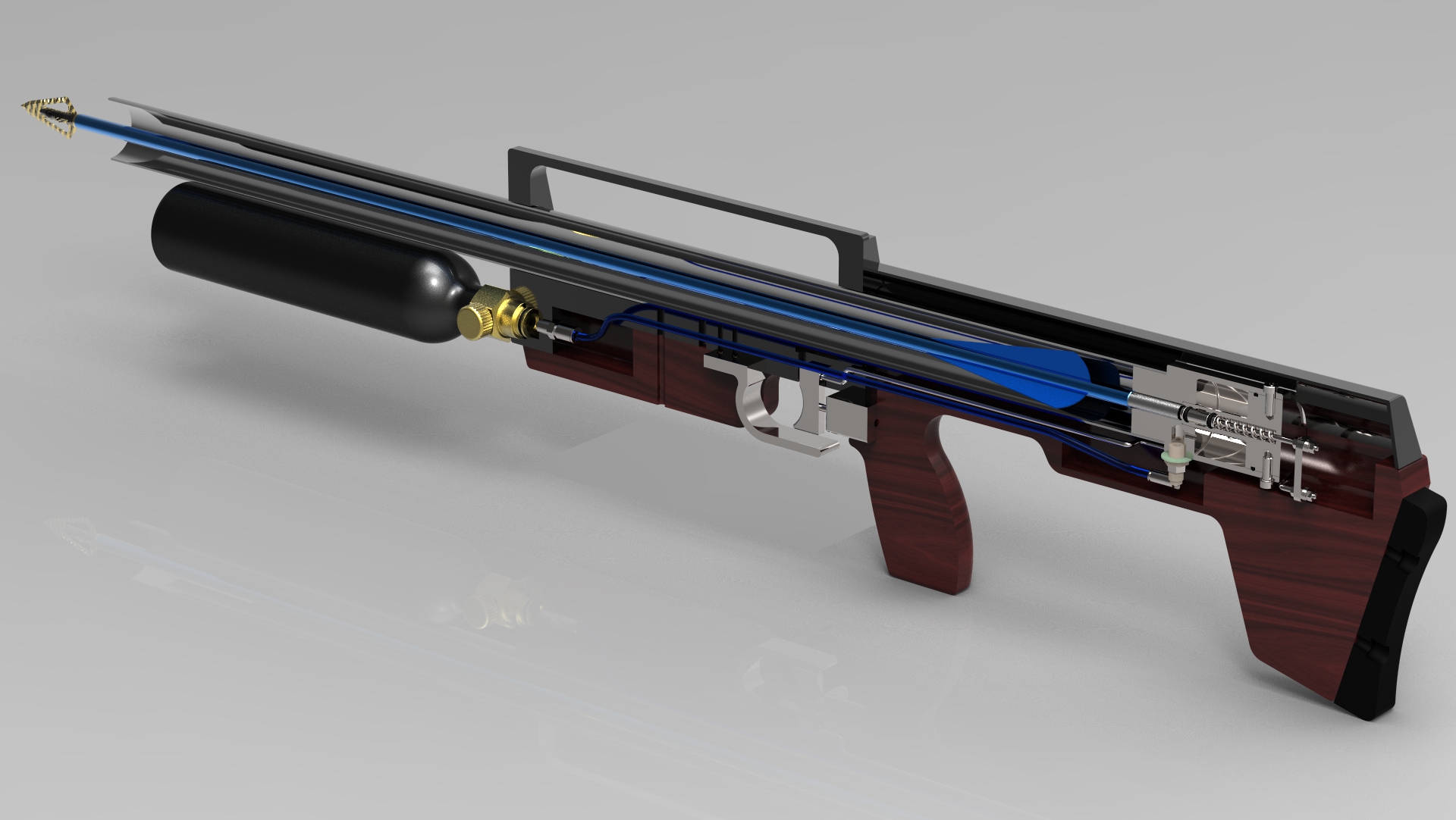

I managed to incorporate a 9oz CO2 bottle into the gun which I am really stoked about. If anyone is interested, I will attempt a rendering that will show the internals of the launcher.

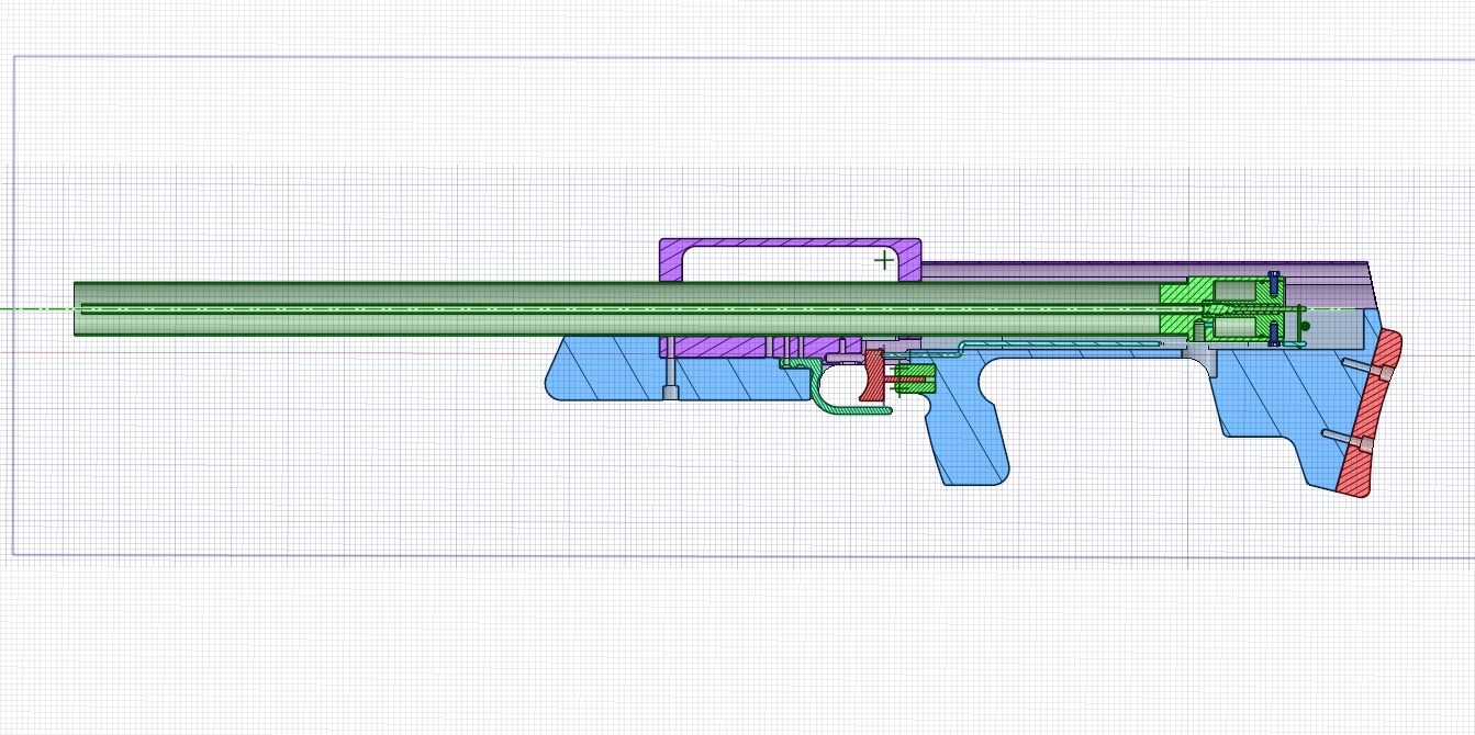

Still trying to make heads or tails of that first drawing... Where is the chamber? Is it that little area behind the arrow? Or does it not technically have a chamber, and instead the valve is essentially dumping just the air in the line between the tank and valve? And then your 'barrel' actually fits inside the arrow? (the tube around it is essentially just for show?)
To the point: what volume are you working with as the chamber?
edit: I think I've got it - the small area behind the barrel is the chamber, released via a manual valve (push rod from the trigger). The barrel is actually inside the arrow, while the tube around it is just looks/safety.
You have the workings right sharpshooter. The shroud is there to protect the barrel and it looks neater too,in my opinion. There is 2.8 "cu co2 in the valve but it looks like I may have to increase that. Although it's a work in progress, here is a rendering of the launcher further along in its design.
