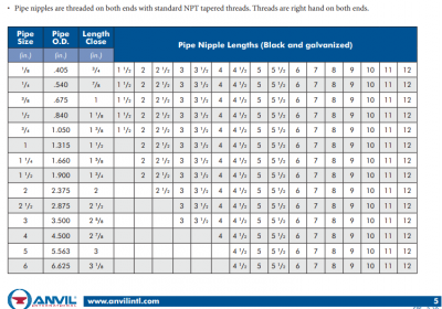

farcticox1
Posts: 1081
Has thanked: 69 times
Been thanked: 96 times
Wed Oct 11, 2017 4:12 pm
Should be able to assemble what you need from the appropriate fittings, if you know where to source them. Barrel nipples come in various lengths so you don't have to worry about cutting threads. :idea:
