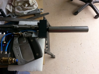

Only 140psi, it's just standard pneumatic parts and PVC chamber, that is enough, it will go through 1/2" plywood.

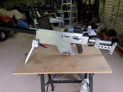

Dude, that magazine system is so cool it's ridiculous.
The whole thing is awesome, obviously, but that mag... Rube Goldberg meets Machinery and it works!!!!

It started simple in my head, then got a bit more complicated, but it does work nicely.

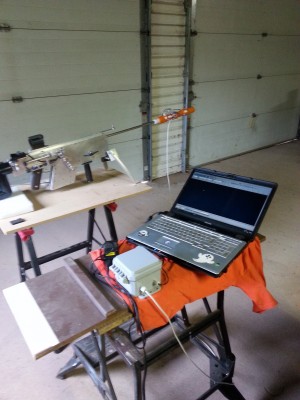

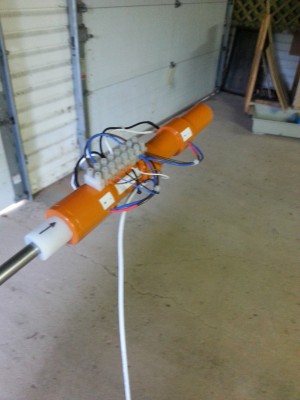

Tested my chrono device, it shows a consistent 416fps at 140psi. 10mm steel BB is about 4.5gms/69.4gr.
Muzzle energy = 27ft.lbf/36joules.
I'm changing the PVC chamber/stock for a stainless one, it has less volume but I will feel safer taking it up to higher pressures. Going to do the same chrono test when I get it assembled again. New stainless chamber. I like the adjustable stock better. The results are in, new chamber at 140psi = 357fps, 160psi = 385fps
