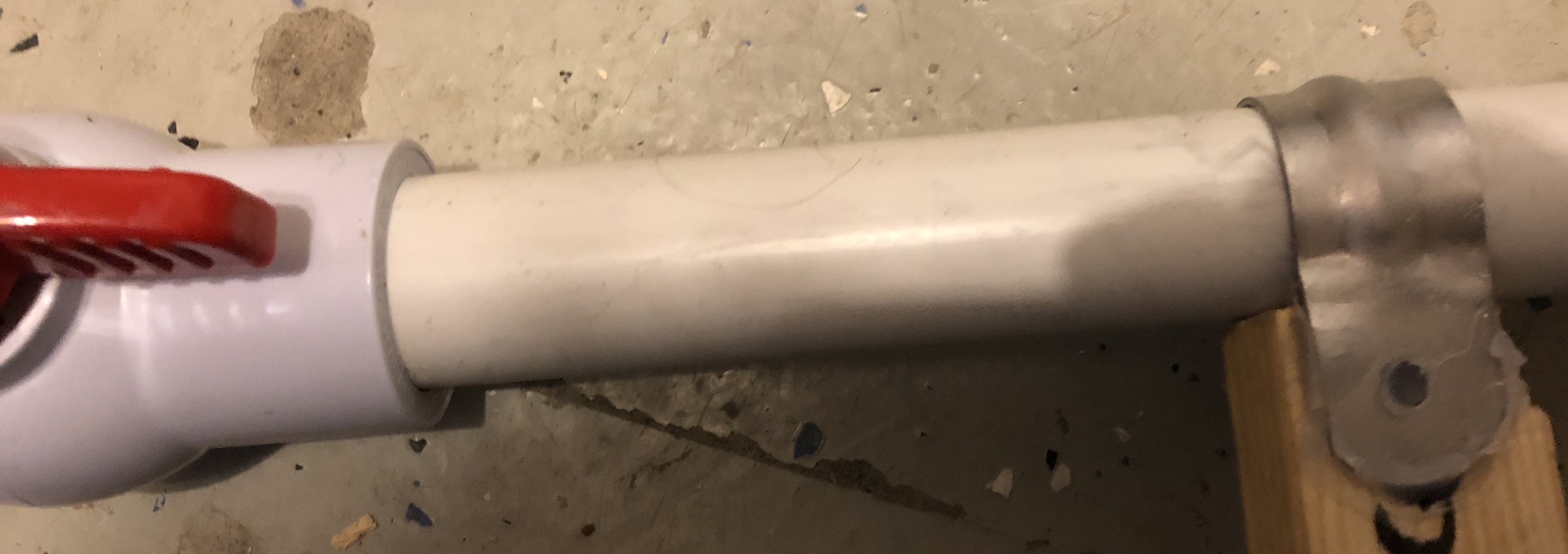

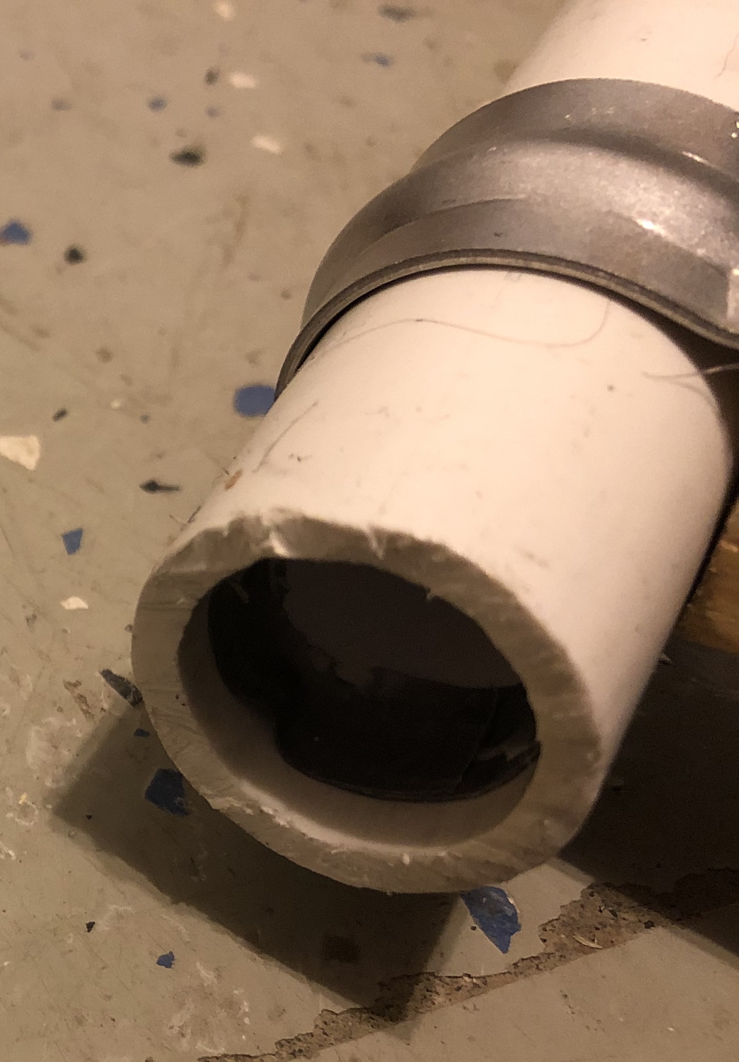

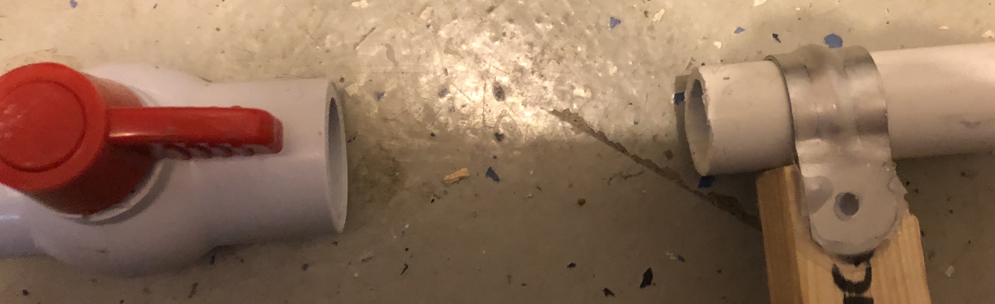

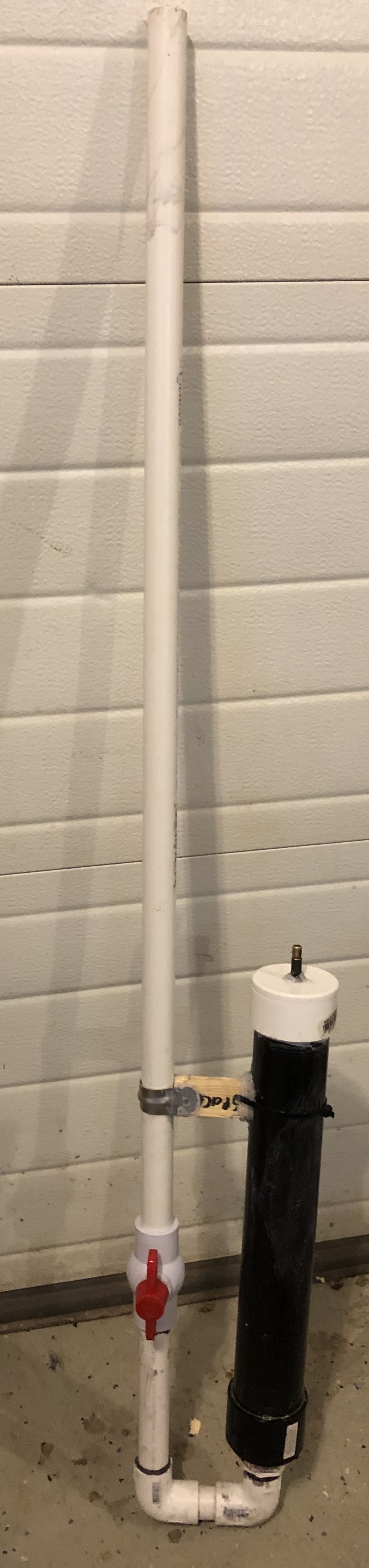

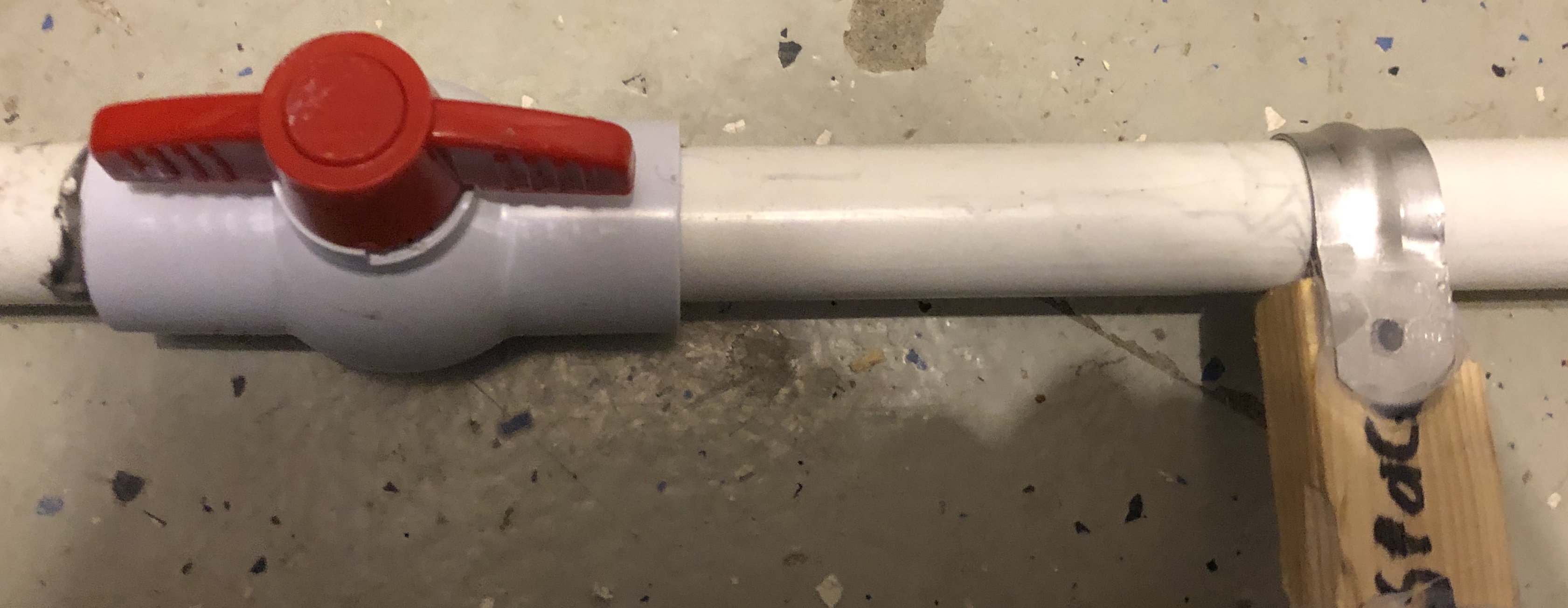

I was at the hardware store a few days ago and I thought “Why not make my 9th spud gun?”. Do I did. It managed to stick a blowgun dart in my garage door from around 10 feet at 100 psi and it shot through 3 or 4 layers of cardboard prior to doing that. The thing that makes it special (for me, at least) is, the barrel slides forward and I can load stuff in like that instead. I haven’t done a range test but I bet it would go 50 to 100 metres. The spacer is a piece of wood (the writing says spacer so I wouldn’t accidentally throw it out) and a bent 35 cent bracket.
The pneumatic.
The pneumatic.
Closeup.
Closeup.
Barrel in loading position.
The dart is in the barrel.
Barrel is in the valve again, time to shut the valve, fill with air, and fire!

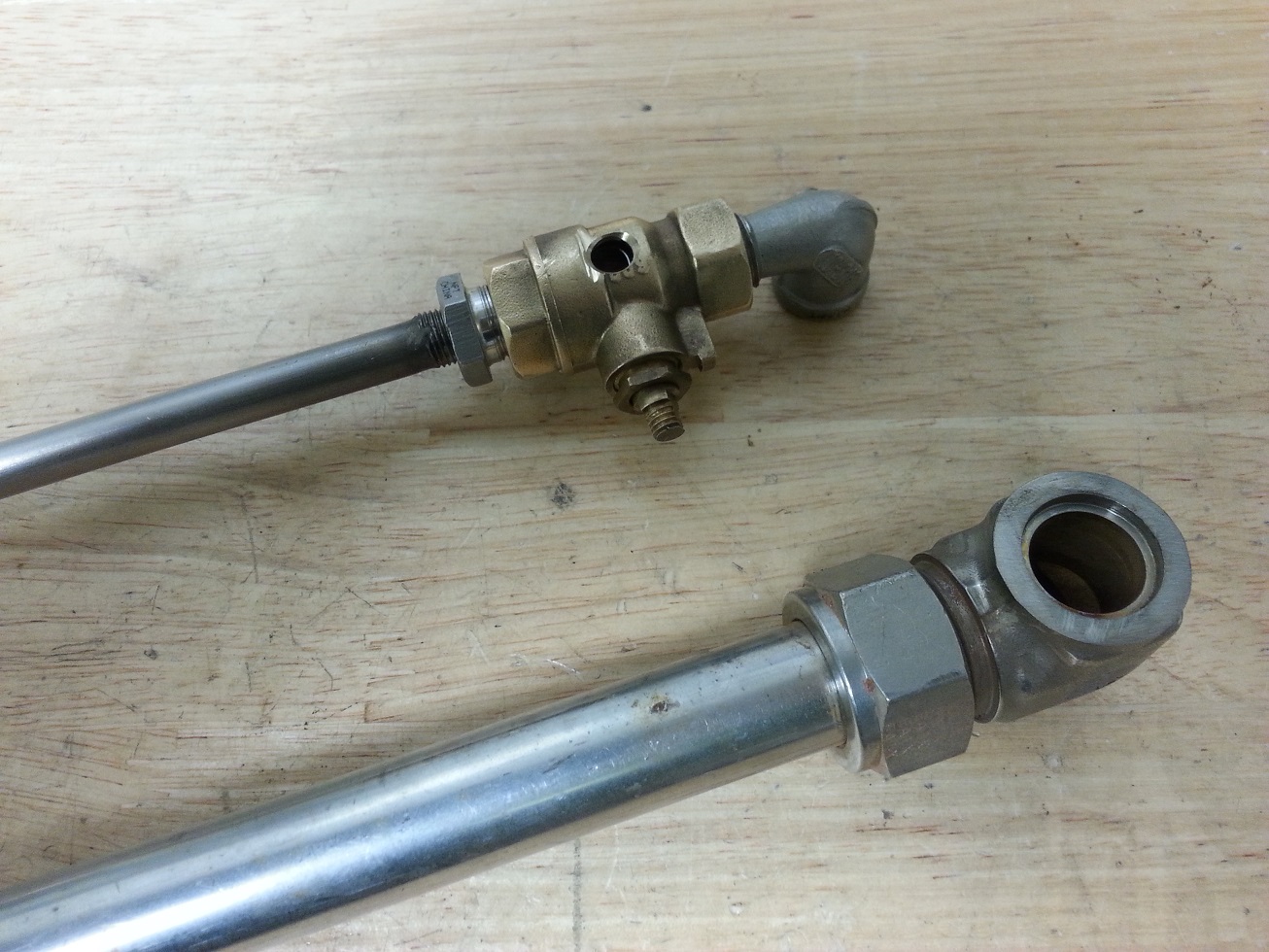

And if you drill a hole in the ball valve you can load straight into it, can cause it to leak a bit though.
