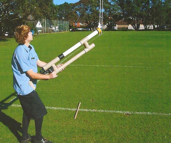

Nice one, I like it. Did you just take a 2" hole saw to that tee so that the barrel goes through it, or did you spend time with a file or similar doing it?

Thanks Mark. Yeah I just used a hole saw, very effective and surprisingly clean.

More testing today, it went really well.
First did a shot with the nerf attached to the line, at 30psi it went 55m going for height.
Second shot was done with the barrel 60cm parallel off the ground, nerf went 65m, third shot was the same but 40cm off the ground, went about 60m.
Halfway through the period there was a fire drill and everyone poured out onto the shooting range, er I mean Rugby field. All the staff came out as well, like the deputies, deans and principal. They didn't seem to mind but boy did I attract a crowd. I didn't do any shots during this time for obvious reasons.
After that me and few friends wanted to see how far the nerf would go without the cable, at 80psi we managed to get two shots off that both went little over 160m. Not bad for such a short barrel and only 80psi.
