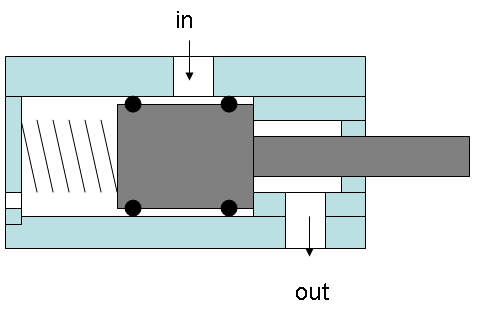

you mean like this?
you also can use a blowgun backwards
- like this.PNG (6.51 KiB) Viewed 5616 times
iknowmy3tables, your design is cool, but if I'm not mistaken, that would tear up the o-rings pretty fast. Correct me if I'm wrong...

no, if you made a really sharp edge it would but control valves, blowguns, sleeve valves and many valves use sliding rubber seals that slide across gaps, so I'm afraid you are mistaken
I don't believe you have seen clide's guns and the o-ring work in his valves
also there is just no reason to depict how smooth the edges are in a simple diagrams
