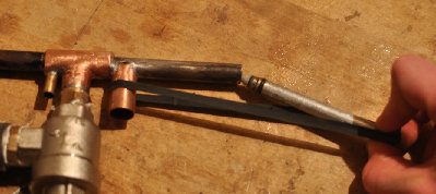

And the blow-back-breech is really nothing new, just a bolt with o-ring and a magnetic tip out of polymorph, a magnet and a sawed down nail, all glued together. I was hoping that the magnet would be enough to prevent the steel-ball to be fired out of the barrel, from the bolt pushing it, but it wasn't so I added 6mm spring-ball-detent (the small brass pipe) Here is a picture of the breech with the bolt pulled out:

nature-boy wrote:But my concerns are, that even without a detent the breech will move to fast... I hope highspeed-footage will show that today...
You mean shoot out the back? MOAR RUBBAH BANDS :D
An airtight detent isn't really necessary, once you have the ball detent in place the air coming from the valve into the bolt far exceeds any leakage past the projectile so it should still be effective.
