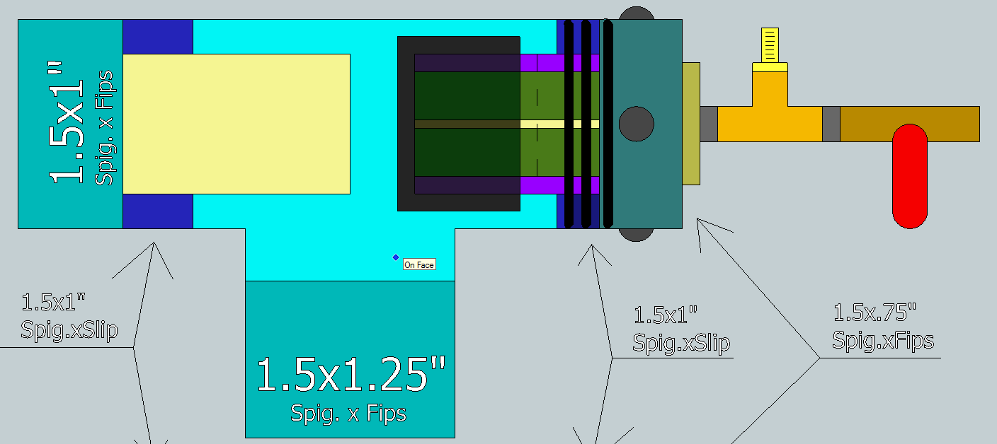

I've always wanted to build a compact piston valve, i.e. one without the female adapter behind the tee. Maybe you could do one in 4"? Then make a semi auto beer can loader

Could you describe this a little more?Gun Freak wrote:I've always wanted to build a compact piston valve, i.e. one without the female adapter behind the tee. Maybe you could do one in 4"? Then make a semi auto beer can loader

He's talking about a piston housing that is fully contained in the Tee itself without any fittings to lengthen it.

You don't have to machine the piston housing...
Shown with rubber cap piston. May be hard to understand. Ask for clearification

I like it!
Looks eerily familiar though...
http://www.spudfiles.com/forums/my-firs ... 12796.html
