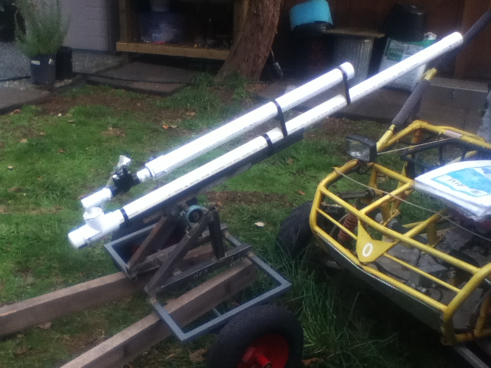

I hate to go fishing but Im looking for ideas on an elevation adjustment system for the cannon/carriage posted below

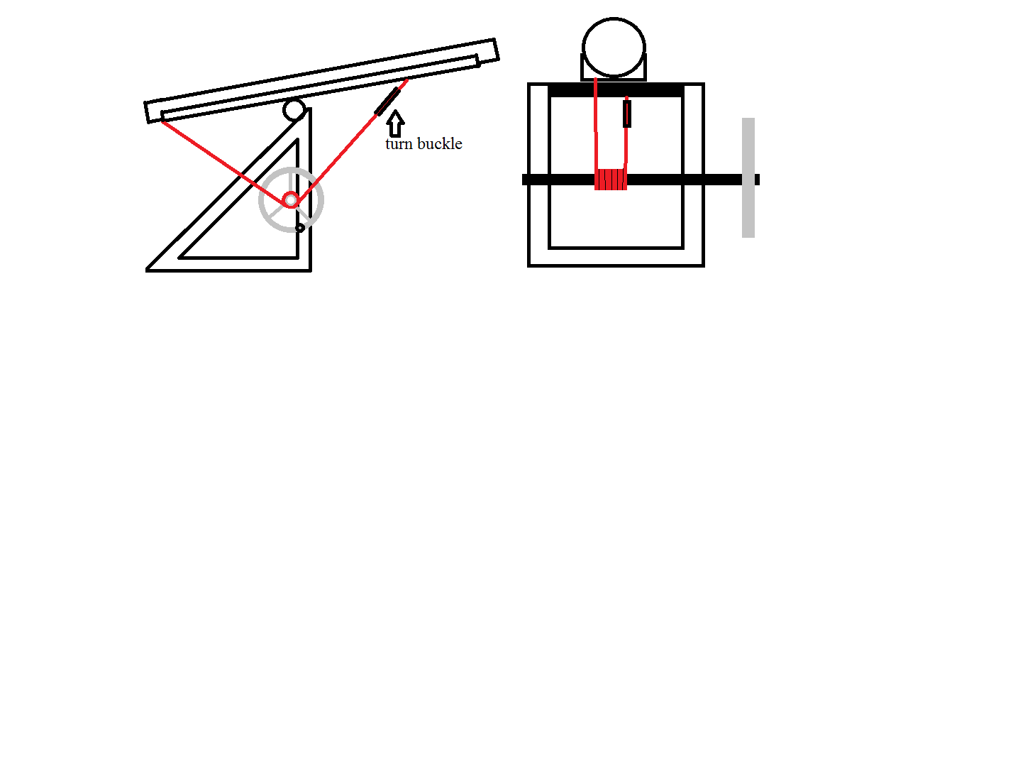

Mon Nov 25, 2013 7:19 pm
Something more along the lines of this (posted below). I prefer the more mechanical approach with ropes and stuff.

mikemurph wrote:yea, the ammo has been changed to a more aero dynamic projectile. it consists of the back half of a dart, and a hot glue ball
AHahahahah!!

Your rope idea is good, but you may want a gear and a bike chain.also you should make it so that it will lock in place. i will probably be back with more ideas

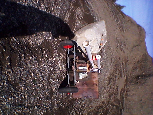

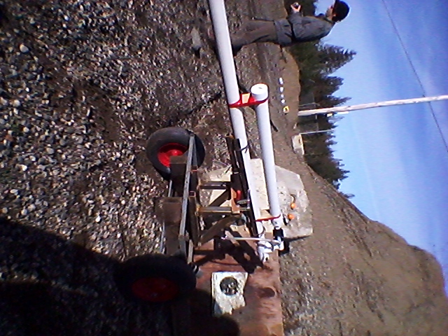

Just an update here :) Cannon kicks butt!! still have to get me some bike gears and chain but were putting manderain oranges 250-300 meters. also moddified the breach to reduce dead space and better air flow
