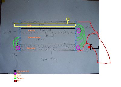

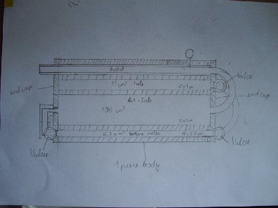

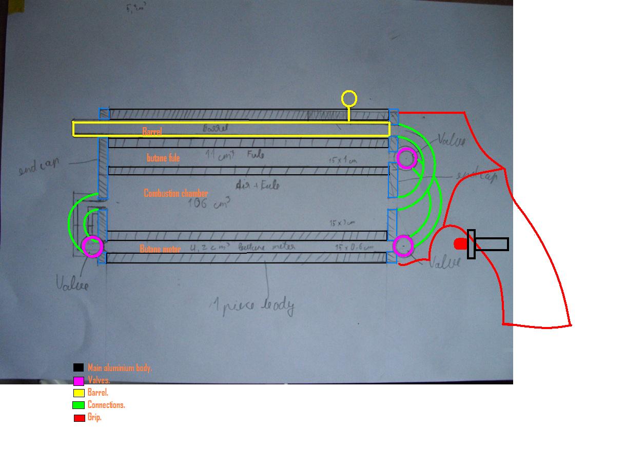

Hello Its my first post on the forum.
I got a idea to make a aluminium gun powered by butane. The main chambers would be made out of 1 piece of aluminium with copper fittings. The ignition would be a BBQ sparker. My grandfather is a retired machinist, so he could help my with the aluminium body and other stuff. I have a huge piece of aluminium, 4cm thick, 15cm wide and 10cm long. I also have a piece of 5mm thick aluminium witch is 30x30cm big. I have 100$ to spend. I am a hobby woodworker so I could make cool laminated grips for it. :roll:
Excuse my bad English, I am from a small country called Estonia.
Original Drawing
Original Drawing
Simplified Drawing
Simplified Drawing

I do not really like pneumatic guns because they usually need pumps or expensive filling stations. If i found a good idea of a semi-auto hand gun i would make one. My design is portable and looks cool. Could my design work?

if you had a way to vent the chamber after each shot and a metering system them of course it would work

Your going to lose some power by feeding the combustion gasses through a small I.D hose to the barrel. That said I would also advocate for pneumatic approach as power can be lacking in small combustions. You don't need expensive fill stations either you can use a bike pump which most people have or a shock pump which can be had for as little as $10.

hEnzza wrote:My design is portable and looks cool. Could my design work?
If made well, your design should work, but as most people will tell you the power will be very disappointing, probably worse than a cheap airsoft pistol.
As pointed out above, a shock pump is compact, will give you high pressure very quickly for a small chamber and online a good one is less than $30 posted to Estonia, you can probably find it cheaper locally.
Not trying to say your idea isn't good, but performance will be limited. If you're willing to live with that, go with it :)

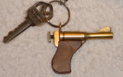

With some basic skills it would be relatively easy to make a pengun-style coaxial and add a pistol grip and thumb trigger, something like this:
