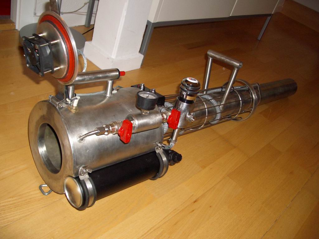

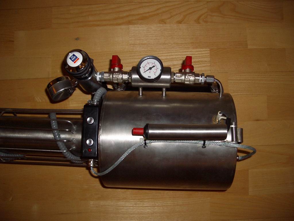

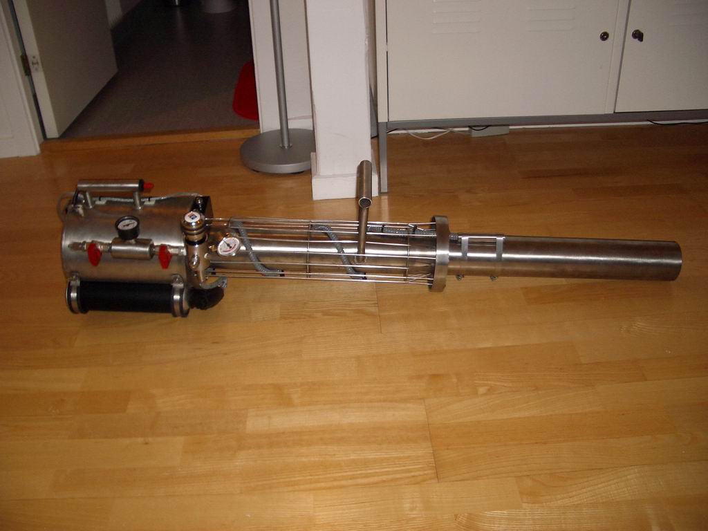

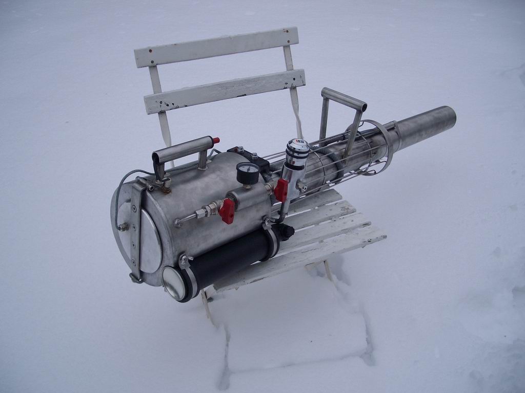

This is my cannon for shooting large oranges, the barrel is Ø80mm. The cannon is made from stainless steel exept the end which is aluminium for reducing wheight. . The cannon runs on special gas (70% butane 30%propane). Sorry my english isn't super, I'm from Denmark.

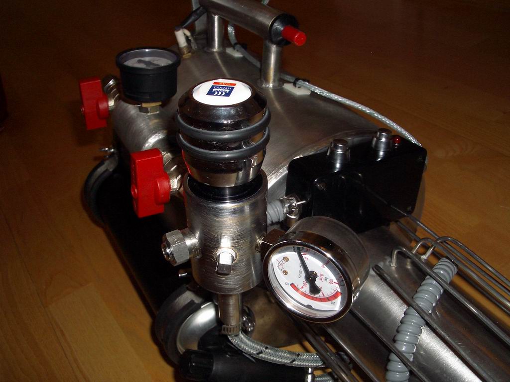

from above, tricker from weber gas grill, all stainless stell cable
the gas bottle is mountede on the side, all custommade

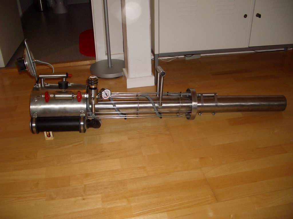

side shot, chamber 7500 ml, barrel 5000 ml, ratio 1,5:1, 108 parts, 300 hours build

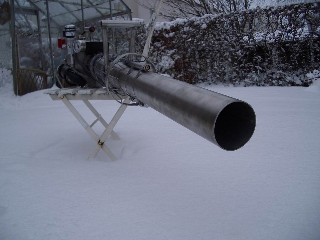

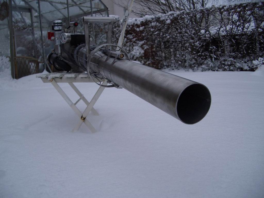

barrel ø80mm, you can almost put your fist in it. Total length 1,3 meter

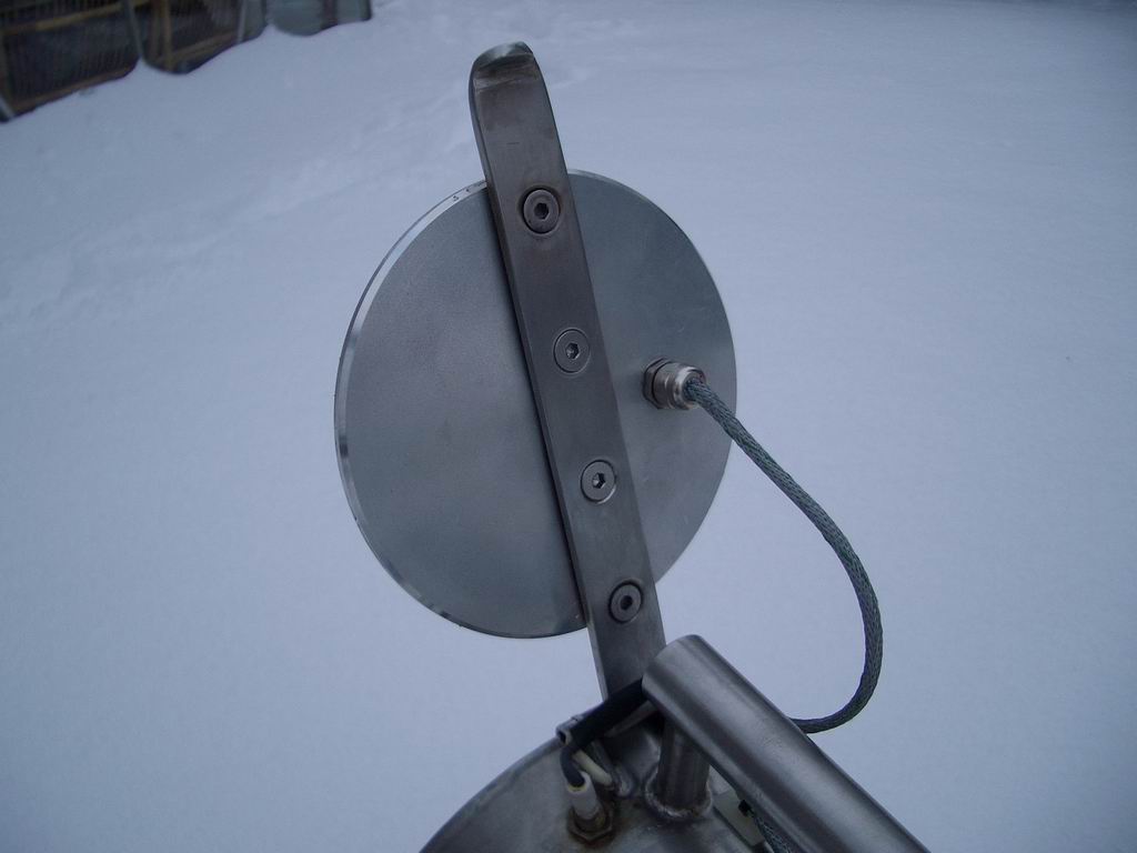

in the danish snow, christmas 2005, machinede alumium endcap

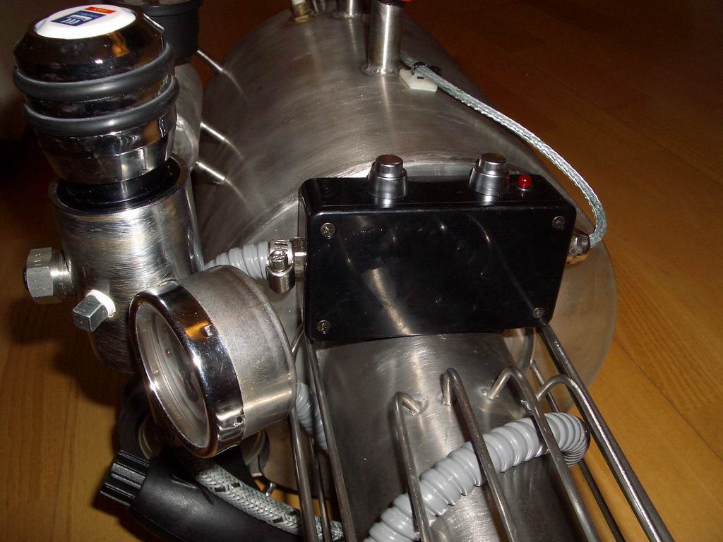

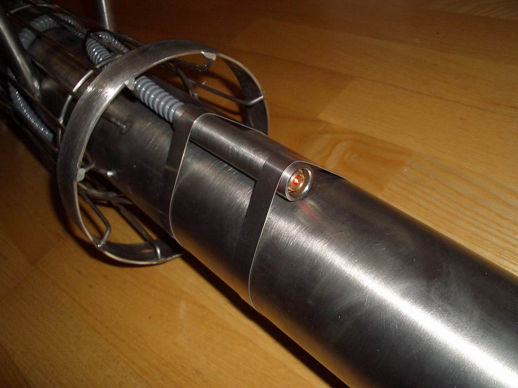

laser, inside stainless steel tube, armored rubber tube for cables for the remote

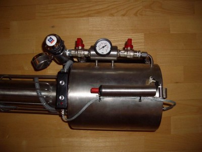

gas meter, with regulator, plus controlbox for ventilator and laser
in profile
in profile

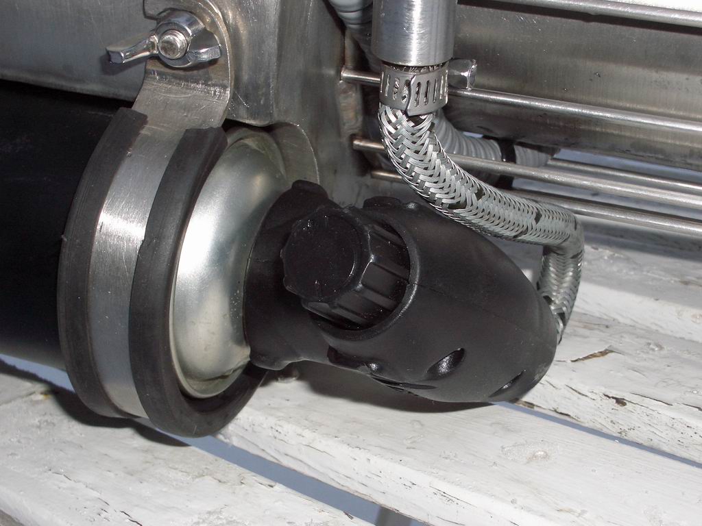

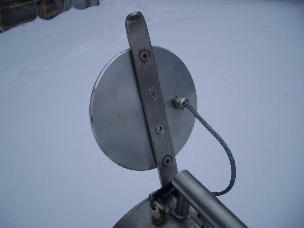

machined alumium end cap with armored cable for ventilator
controlbox with buttons for laser and ventilator. 9 Volt batteri inside for the ventilator...

That's one awsome gun. Does the ring in the middle of the barrel have any function besides ending the basket wires?

boilingleadbath wrote:That's one awsome gun. Does the ring in the middle of the barrel have any function besides ending the basket wires?
the ring is mostly for the mean look, but i also protects the laser and the cables for it...

What is the smallest wall thickness of the chamber?
Klinge
Posts: 9
Joined: Thu Dec 22, 2005 6:40 am
Wed Jan 04, 2006 3:53 pm
wesman987 wrote:What is the smallest wall thickness of the chamber?
1,5 mm
