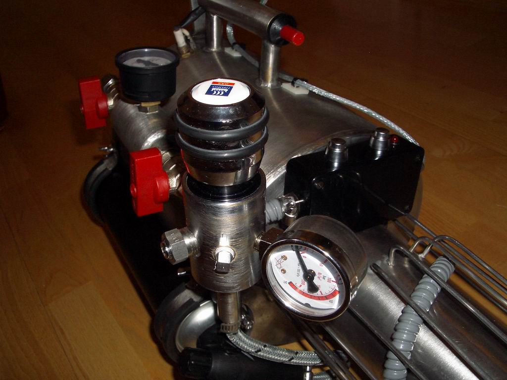

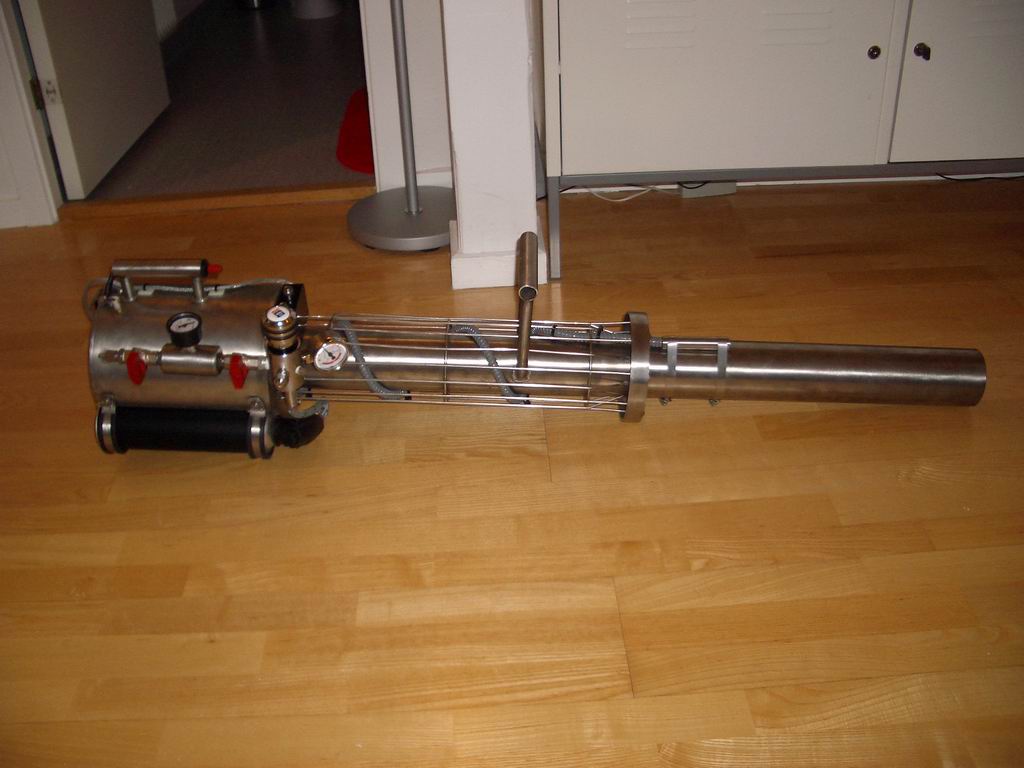

This is my cannon for shooting large oranges, the barrel is Ø80mm. The cannon is made from stainless steel exept the end which is aluminium for reducing wheight. . The cannon runs on special gas (70% butane 30%propane). Sorry my english isn't super, I'm from Denmark.

That's one awsome gun. Does the ring in the middle of the barrel have any function besides ending the basket wires?

The special gas, is it Gasol? I've experimented with that but couldn't find the right mixture...Have you tried to shot something other than oranges?

the ring is mostly for the mean look, but i also protects the laser and the cables for it...boilingleadbath wrote:That's one awsome gun. Does the ring in the middle of the barrel have any function besides ending the basket wires?
The cost is pretty difficult to say, because a lot of the materials I already had, but my guess is somewhere in the area of 1000-1500 us dollars + 300 work hours. Stainless steel is very expensive.Holy S*^# Its Still Going wrote:THats asome how much did it cost you and can you post some plans
The gas is pretty normal bottlegas in denmark used for small wellding equipment and camping. We havn't got 100% ´propane like in the US. The mixture I use is around 3,6 %. The cannon is used with any kind of fruit that fits the barrel, large onions, appels... snow is also fun this time of year.... your friends quickly learn not to shoot snow at you, because I will shoot back:-)Copperboy wrote:nice gun, big bore rules!!![]()

Total fabrication time is around 300 hours over a period of 3-4 monthwesman987 wrote:That is one of the best looking launchers I have ever seen, excellent job. How much time do you think it took you to fabricate and machine all of the parts for it?

What do you use as an electrode? I'm thinking along the lines of a sparkplug. For my combustion, I lathed a hole through a bolt and glued a wire into it.

I used a complete igniter set from a weber gasgrill.drac wrote:Oh my, I forgot to say GREAT F***ING JOB!!!
I gotta admit, that thing looks sexy. My metal combustion pales in comparison to yours. This would put mine to shame.
