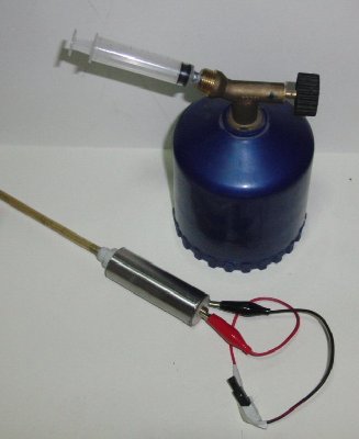

fuelling and firing setup, with blowlamp butane/propane fuel source, syringe meter and cigarette lighter piezo ignition.
