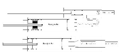

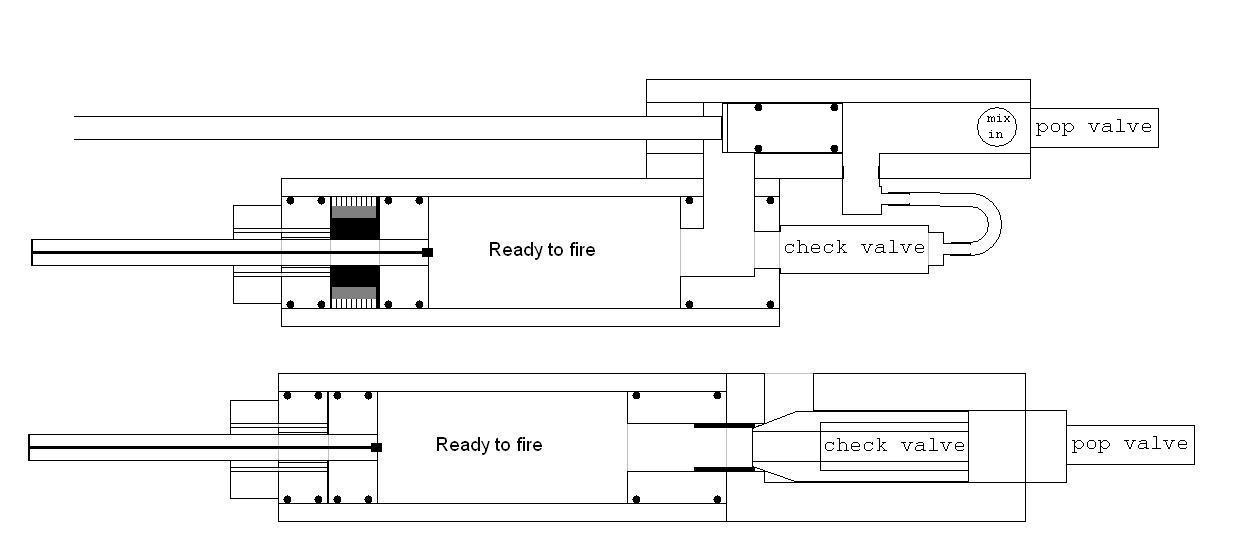

O.K. I think I have got the idea now. Please let me know what you think of this design for a valve. The first design in the picture is the one that I am thinking of going with, I designed it first and I think is better than the bottom design. I started on the bottom design cause I thought that it was a good idea, but now I am thinking the top is better. I think it is pretty self explanatory but let me know if I left something out or you don't get something. So please give me your thoughts on this design.

also one thing I am not sure about is the pop valve exhuasting of the pilot chamber. I mean will the pressure on the front of the piston force it back and start leaking out before the pop valve can open, or does it all happen so fast that it isn't noticeable? Also how do you calculate at what pressure the valve will open? I suppose you have to calculate the combusted gas pressure and surface area of the face of the piston that is exposed when sealed to the barrel?

edit: The sequence is: The piston will start on the right side of the valve chamber, the incoming fuel mix will force the piston to the left side sealing to the barrel and opening the way to the combustion chamber through the check valve. The pressure will equalize between the pilot chamber and combustion chamber. So now there will be about 90psi behind the piston. when the mix is ignited the pressure will force the piston backwards which will increase the pressure and cause the pop valve to open and vent the pilot chamber. The piston then will be forced back and the gasses to go out through the barrel.

This looks to me like just an overcomplicated version of a normal piston valve. Really the only addition over a normal pneumatic piston valve is the check valve connecting the pilot volume to the chamber, which could even be incorporated into a piston design.
EDIT: Blurred a little on upload... but I think this is more the design we discussed... am I wrong?
couldnt the mix behind the piston ignite when the piston is forced back even with the check valve it still might be able to build up enough pressure fast enough to ignite the mix?

on the pilot area: I did not clarify something here, the propane will be introduced first, then the compressed air will come in behind it and force out the propane into the combustion chamber. So no ignitable mix will remain in the pilot area.

The second design in the first diagram is exactly what my piston hybrid looks like (<a href="http://www.spudfiles.com/forums/bolt-ac ... html">link here</a>). My launcher does not use a pop-off valve, for a few reasons. First, I'm not sure that a pop-off in a chamber sealing valve will really improve performance all that much. Second, the sealed pilot area acts is an air spring that slows the piston down, preventing it from impacting the back plug, and then resealing the piston. Finally, because the pilot does not need to be refilled from shot to shot, I can achieve a better rate of fire.
