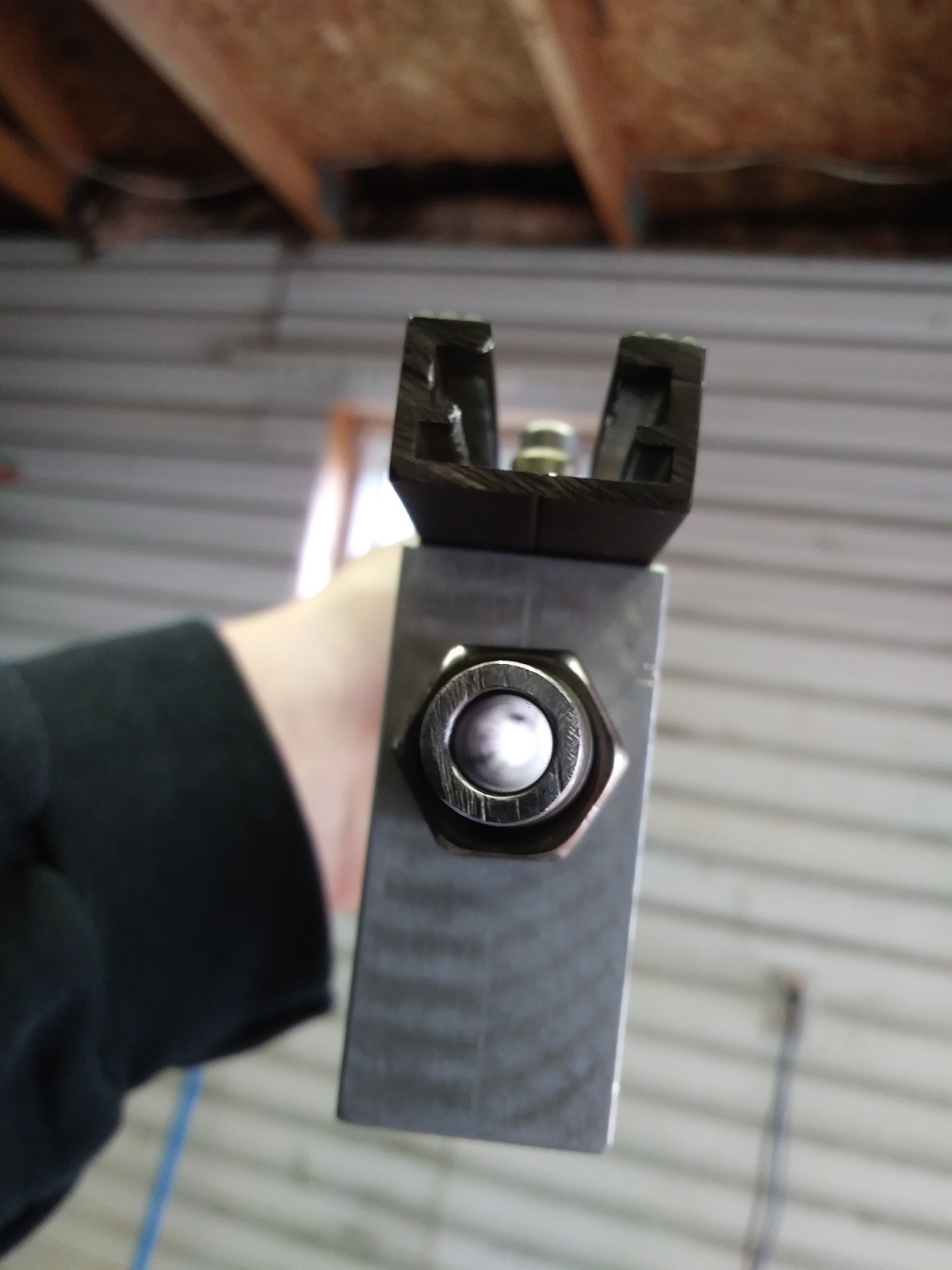

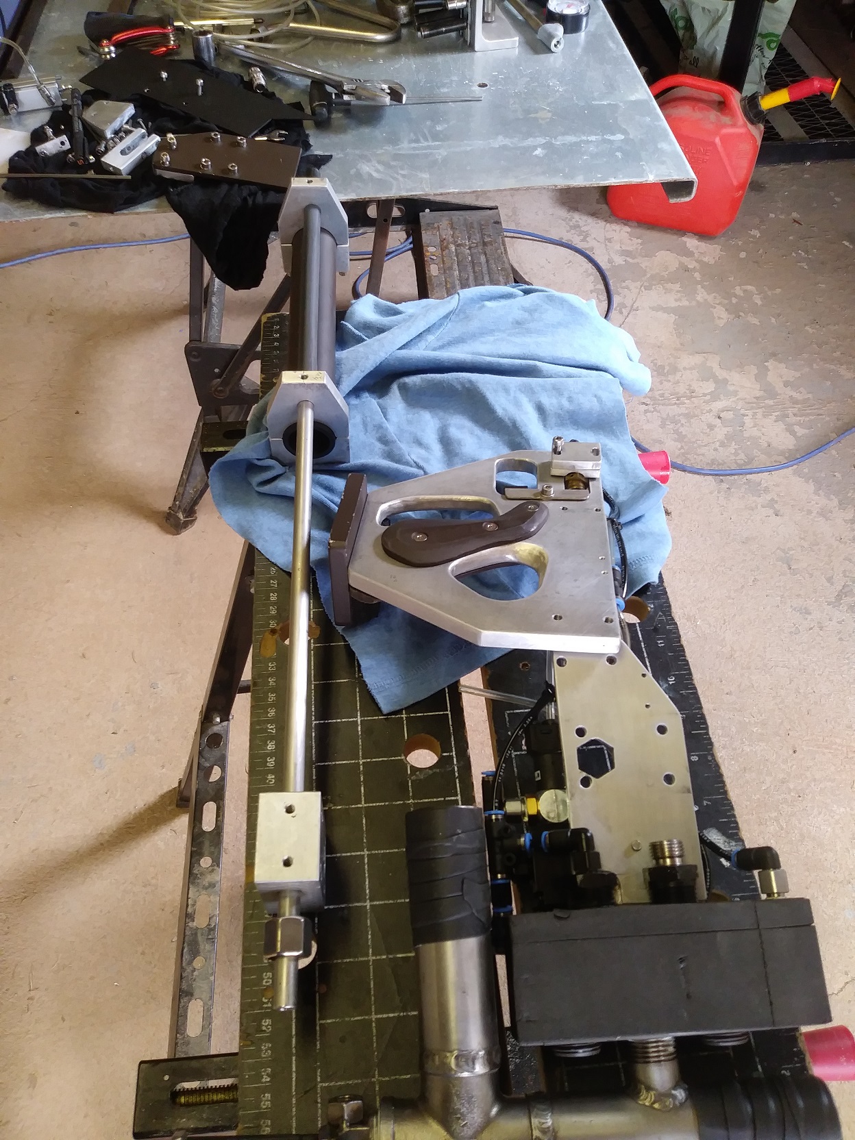

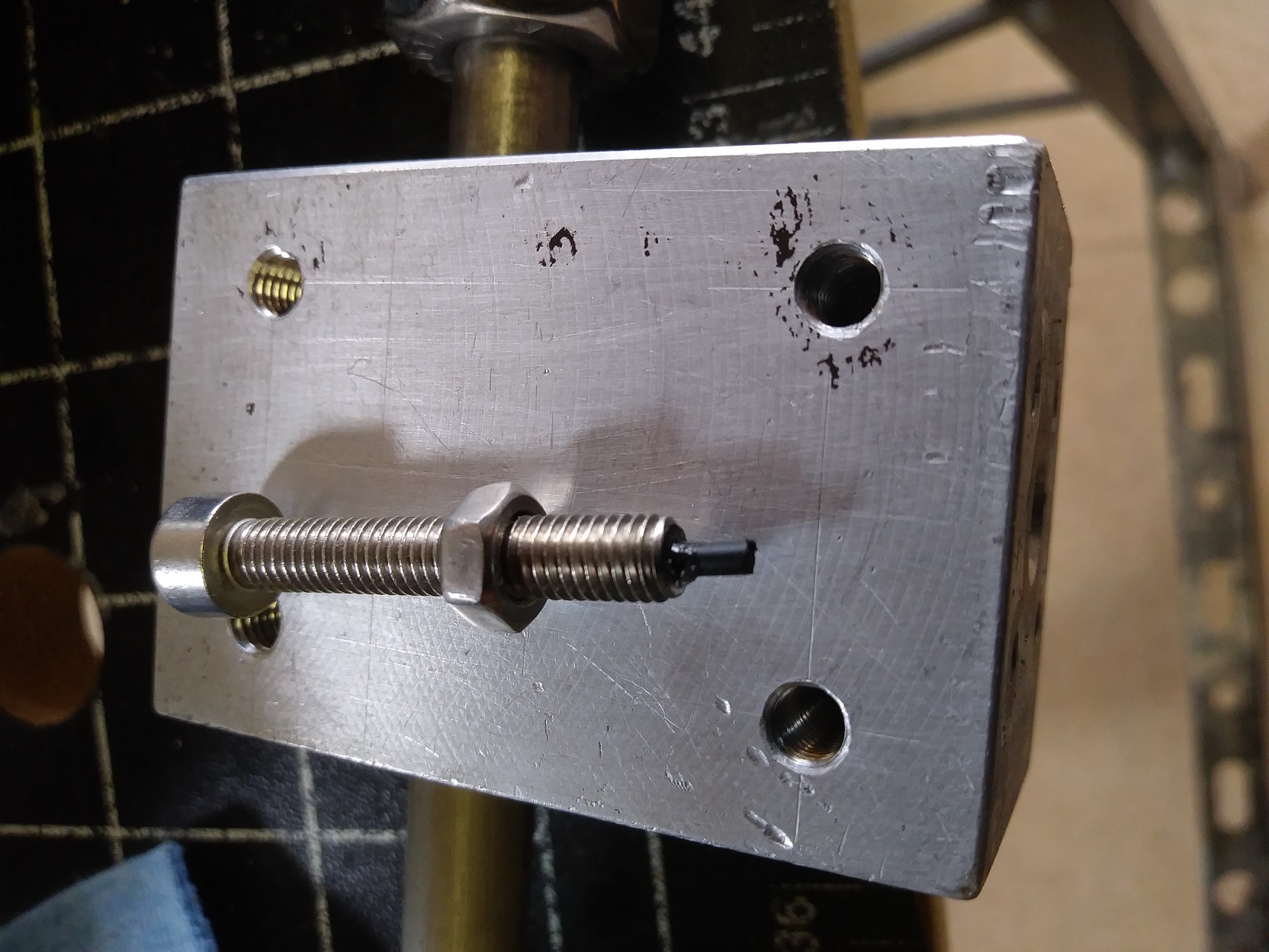

A bit of Sunday tinkering and it's in pieces.
Polished out the barrel and made hop up, to stop BB's rolling out as much as anything. Drilled down center of bolt and stuck in a piece of 'O' ring material with silicone.
hop up just visible down barrel.
Mainly trying to get better accuracy.

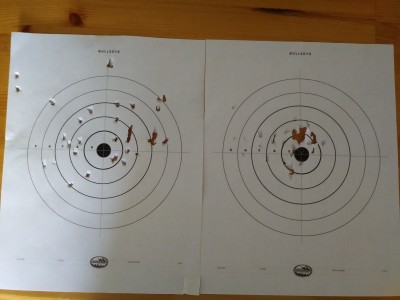

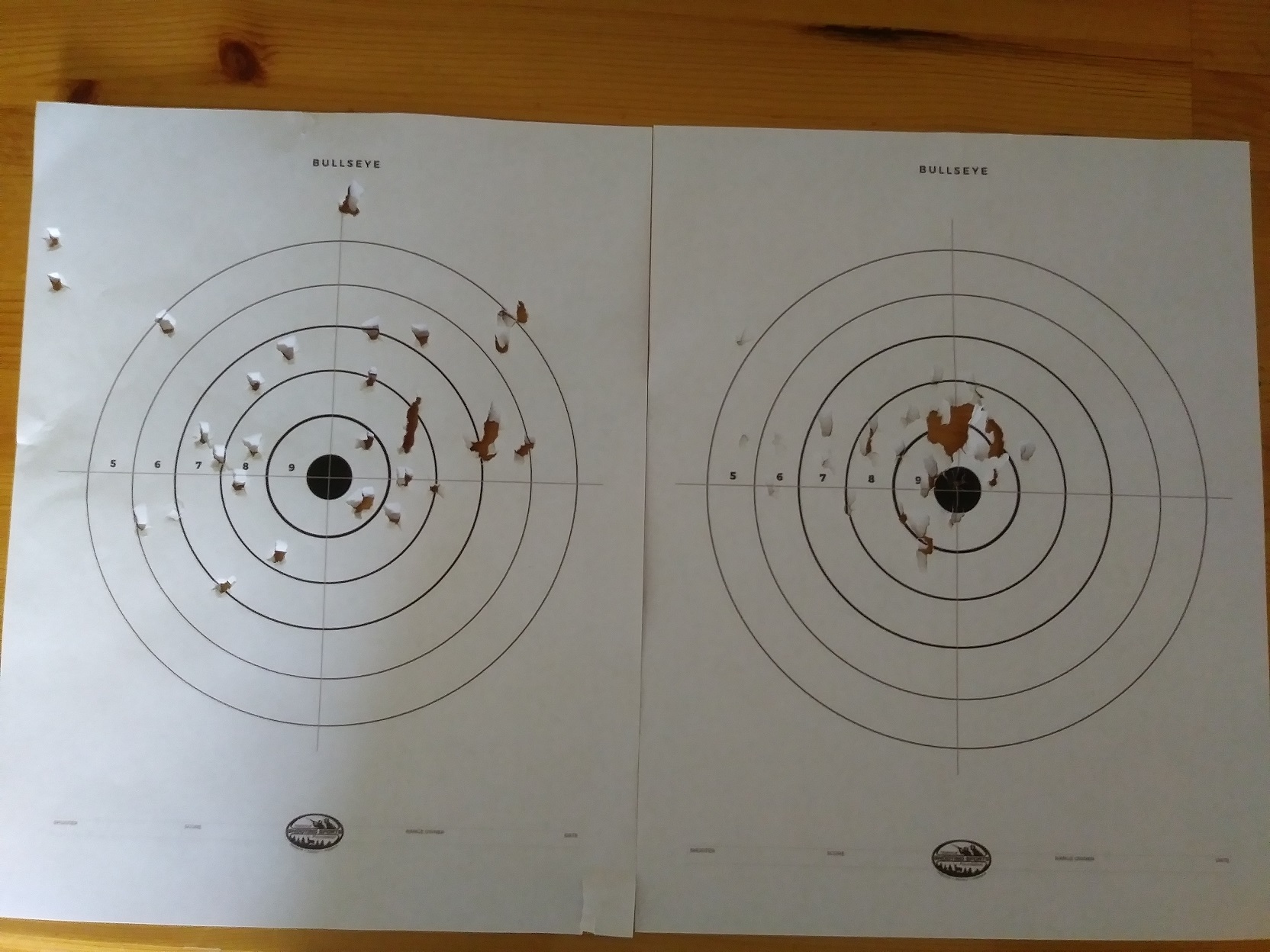

And the results after reassembly. Still some horizontal spread, but much better
Before and after
Before and after

Hop up increases range, not accuracy. If anything it decreases accuracy.
For your build a Systema PTW style hop up should be easy enough to integrate.
