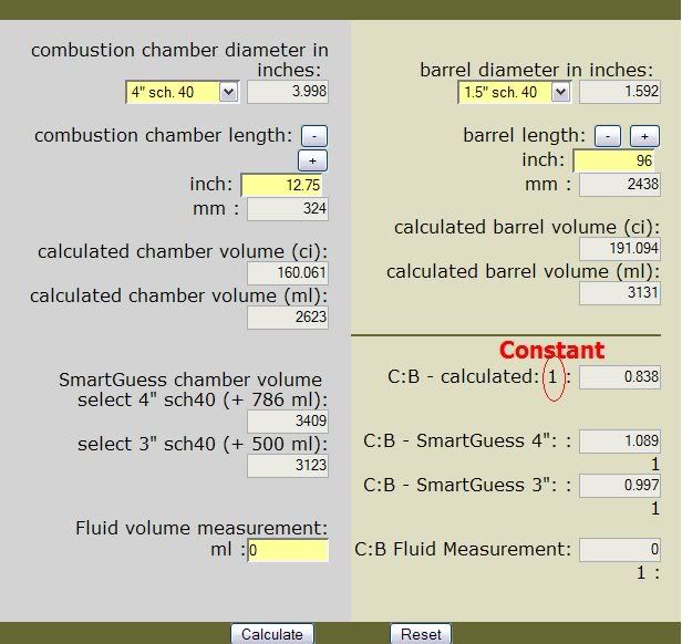

Yea it shows .8:1 C:B as the best ratio. I guess I'm confused because on RatCalc it has 1 : x as a constant on the website.
According to my calculations, the test they did was with a 1.5" barrel at 8 feet (96 inches).
All we're given is that it's a 159ci chamber which in turn would be a 4" diameter 12.75" length chamber... or 3" diameter 22" length chamber.
Now thats for 0.8 ratio as noted in the value box
C:B - calculated: 1 : 0.837
So I'm just wondering if its actually 1.5:1 or 0.8:1 is actually better.
(Although isn't that technically like... 1:0.8 chamber to barrel ratio on the tool? I don't know it seems as if it's backwards.)

The difference between the same test with variable barrels is that a .08:1 and a 1.5:1 ratio is the difference between a 96" barrel compared to a 54" barrel lol. But the .08:1 calculations seem accurate and reliable so I think I'll stick with those measurements unless anyone else has some input =)
Ecstasy
Posts: 17
Joined: Mon Mar 24, 2008 10:55 am
Thu Mar 27, 2008 5:12 pm
Ah okay, .08:1 it is. Still the RatCalc thing being backwards listing it as 1 : x instead of x : 1 is throwing me off, but I think I'm set.

I do believe the Ratcalc is backwards.
It may not matter, but I've always built my combustions (and hybrid :wink: ) around a.8:1 ratio.

When you say 0.8:1 is the best, is the chamber 0.8 times smaller than the barrel? or visa versa...
Hubb
Posts: 2390
Location: South Georgia
Fri Mar 28, 2008 1:23 am
C:B, or chamber to barrel, ratio. This means the chamber's volume (not length or diameter) is 8/10ths the size of the barrel's volume.
Example: The barrel volume is 10 cc. To obtain a .8:1 ratio, the chamber would need to be 8cc.
