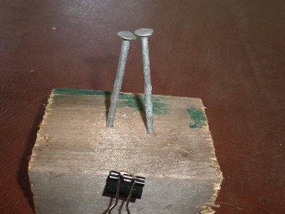

This is my high voltage generator, its the transformer from a fly zapping lantern, Just connect the two wires to your two nails, and make sure it sparks.
Put them together like this, leaving a small spark gap between the nails. You clip the bottom of your balloon into the document clip.

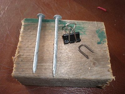

To build the holder you need a lump of wood, two nails, a document clip, and a way of attaching the document clip.

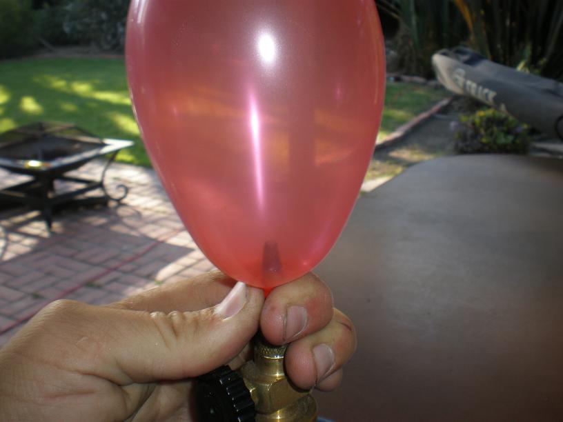

Just fill up a water balloon or any balloon then tie the bottom.
This was left over from my advanced combustion gun, the valve part of a propane torch and a hose connector.
