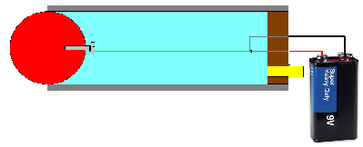

Thu Sep 29, 2011 5:14 pm
KS-collector wrote:what type of valve do you think would work best? Im thinking sprinkler valve, but still debating.
A sprinkler valve on every cartridge is a bit much, assuming you still want cartridges. Tons of other options if you use your imagination.
For example:
