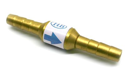

Could this type of valve serve to block the return of gases from a hybrid? :?
Anti-return valve for oxygen hose with ball
hb arrestallama oxigeno bolilla.jpg (14.95 KiB) Viewed 5694 times
