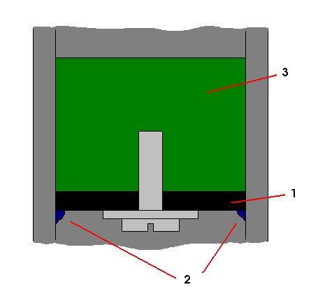

Here's how I cast pistons out of epoxy:
As per the other casting tutorial, the first thing you have to do is get yourself some marine epoxy resin, like for example this stuff, the important thing is that it has low viscosity so it will flow well for casting purposes, and that it sets as a solid resin.
1) cut out a rubber disc slightly smaller (around 0.5mm or 0.02 inches) diameter as the tube in which your piston will travel. Drill/punch out (using a sharpened tube) a hole in the middle through which you can insert a bolt with a washer. If necessary, apply JB weld or araldite to ensure that the seal between the bolt and washer are airtight.
2) lubricate the sides of the tube in which you're going to cast with a very thin layer, anything from automotive grease to KY jelly will do as long as its not a substance that will disolve in the epoxy. Insert the rubber disc and make sure its face is at 90 degrees to the tube. It's important that the space between the disc and the tube is sealed, if the fit is tight enough you can smear grease to keep it sealed, if not a thin application of JB weld to fill the gap will do.
IT'S IMPORTANT THAT YOU HAVE EVERYTHING ALIGNED AND SEALED BEFORE YOU EVEN THINK ABOUT MIXING THE EPOXY - it will be too late to make adjustments afterwards, this method of construction is VERY unforgiving.
3) Once you're satisfied the seal is airtight, mix the marine epoxy and pour it. The length of the whole piston should be at least as much as its diameter. Note that epoxy is very heat sensitive, store it at room temperature before mixing - if not, use a baine marie to heat it up before mixing - (some valid pointers on cold temperature bonding). I find that syringes are ideal to mix it in the correct ratio, and always calculate roughly how much you need so you don't mix too much and have to throw it away - if you take care of it, a pack will last you through many different projects. Clean up any spills immediately or you'll regret it, this stuff sets hard!
Allow 24 hours (or more in cold weather) for complete curing, then tap out the piston with a wooden dowel or similar. Lightly sand the sides of the piston until it's a loose enough fit in your chamber tube to allow you to push it easily with one finger. Do this little by little as its very easy to remove too much material. The piston should now be ready for use.

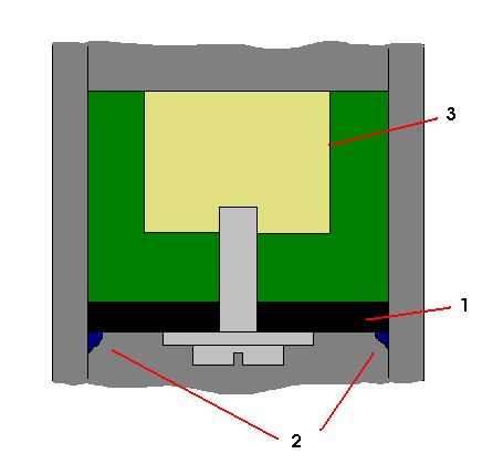

To make a lighter weight hollow piston, follow the second diagram - cut a cylinder of foam approximately half the diameter of the piston and attach it to the bolt before pouring the epoxy.

lightweight piston variation
epoxy piston diagram

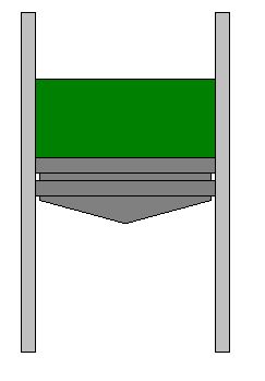

Nice tutorial. I liked some of your designs, though, that included a syringe tube piston housing and the piston as the syringe plunger. Any specifics on what type of tubing a syringe tube will fit into?
Fri Jun 22, 2007 9:59 am
markfh11q wrote:Nice tutorial. I liked some of your designs, though, that included a syringe tube piston housing and the piston as the syringe plunger. Any specifics on what type of tubing a syringe tube will fit into?
That's even simpler to make, simply remove the plastic plunger and just put the rubber seal in the syringe tube, make sure it's straight and just pour the epoxy in the back as per the diagram.
However I must point out that I stopped using this sort or piston for two reasons:
1) Due to the perfect seal, you either need to put a filling valve in both the chamber and the pilot area, or make a connection from the pilot area to the chamber with a check valve in the middle.
2) The tight fitting rubber creates a lot of friction which doesn't allow the piston to move fast enough for optimum performance.
Personally, I would recommend the revised design that is the subject of this tutorial.
syringe tube cast piston

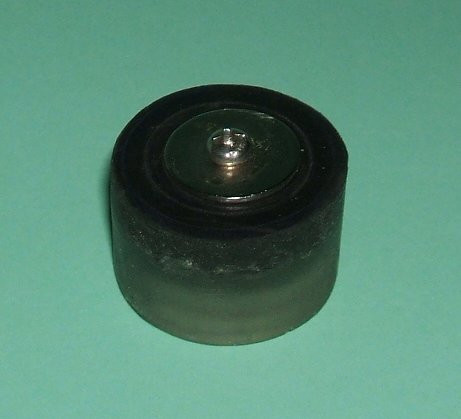

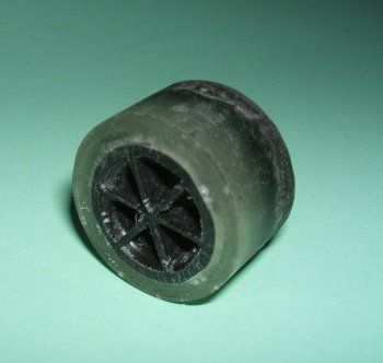

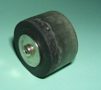

Coincidentally I have a few photos to hand, this is a 1" piston that fits in a syringe tube which I recovered from one of my 3/4" coaxials which I dismantled (for which read "destroyed" :D ) recently. Note that to save some weight (though not that much really, it was mostly done for pointless cosmetic purposes) I used the end I chopped off a permanent marker casing to create the "hollow" section at the back. well, I thought it looked cool.

im just wondering if there is a reason for the color variations in the piston
Velocity
Posts: 1039
Fri Jun 22, 2007 4:29 pm
Damn thats clean... smooth and round. Thanks for the pictures.
