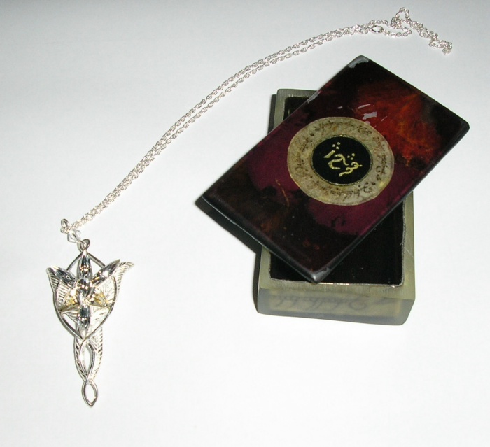

spud yeti wrote:How is the best way to pour resin in so that you dont get bubbles of air in it.
To avoid bubbles, all you have to do is mix it and pur it slowly - however it isn't really important in this case, because the epoxy is low viscosity and therefore the bubbles will rise to the surfact, which is the back end of the piston.
It's really just an aesthetic thing, the only time I cared about bubbles was when I cast a jewel box as a present for my g/f (see attachment)
I mix my epoxy by clamping a piece of wood or plastic in an electric drill and blending away, it's bubbles galore but it never bothered me.
LOTR themed jewel box cast in epoxy resin

O ok cool. WOW thats such a cool box, see must have been happy (the returns great too!! :lol: )
I mix PVA paint the same way as you, lol, its brilliant! Im trying to adapt an electric cooking beater for that use too!
I guess what youre saying about the bubbles is true, never thought of it like that!
btw, what language is that on the box??
Has thanked: 581 times
Fri Jun 22, 2007 5:30 am
It's her Elven name, she's a big lord of the rings fan :roll:

spud yeti wrote:What is the name (like how would you say it)?
Alassë. Poetic, isn't it?
