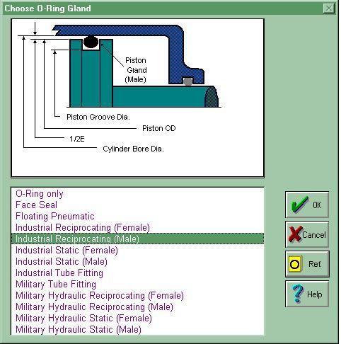

the first discription and link is for a free oring program.
mostly you point and click your way through selections with some size inputs
for example on gland selection you can choose between
o-ring only, floating pneumatic piston seal, industrial reciprocating (female or male,) industrial static (female or male) , industrial tube fitting boss seal .
also the military version of each of the above
[img]
metric or inch
the above choices have application diagrams and a reference button for your benefit .
if you know some of the info it'll figure out the rest.
and give you dimensions or if applicable a dash number
you don't have to to use the program but you can read thru the included references ,index's, and o-ring users guide
if you still have a hankering for more info the second link is around 300 pages of pdf book .,, unless your planing a career in orings or are real curious It's probably overkill.
