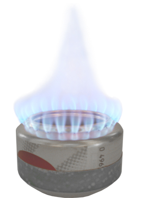

But jack is right.Methylated spirits is ethanol with a enough methanol and dye in it so that you won't drink it.
Methanol will turn to formaldehyde once your body processes it.Good if you want to go blind then save on embalming costs.But otherwise not a good thing to have around.
You can use ethanol or methanol in the place of Methylated spirits.I use all three in my camping stoves.Works fine.And maybe I should start calling them jet engines instead of stoves
All the guy did was make a very junky alcohol burner.
