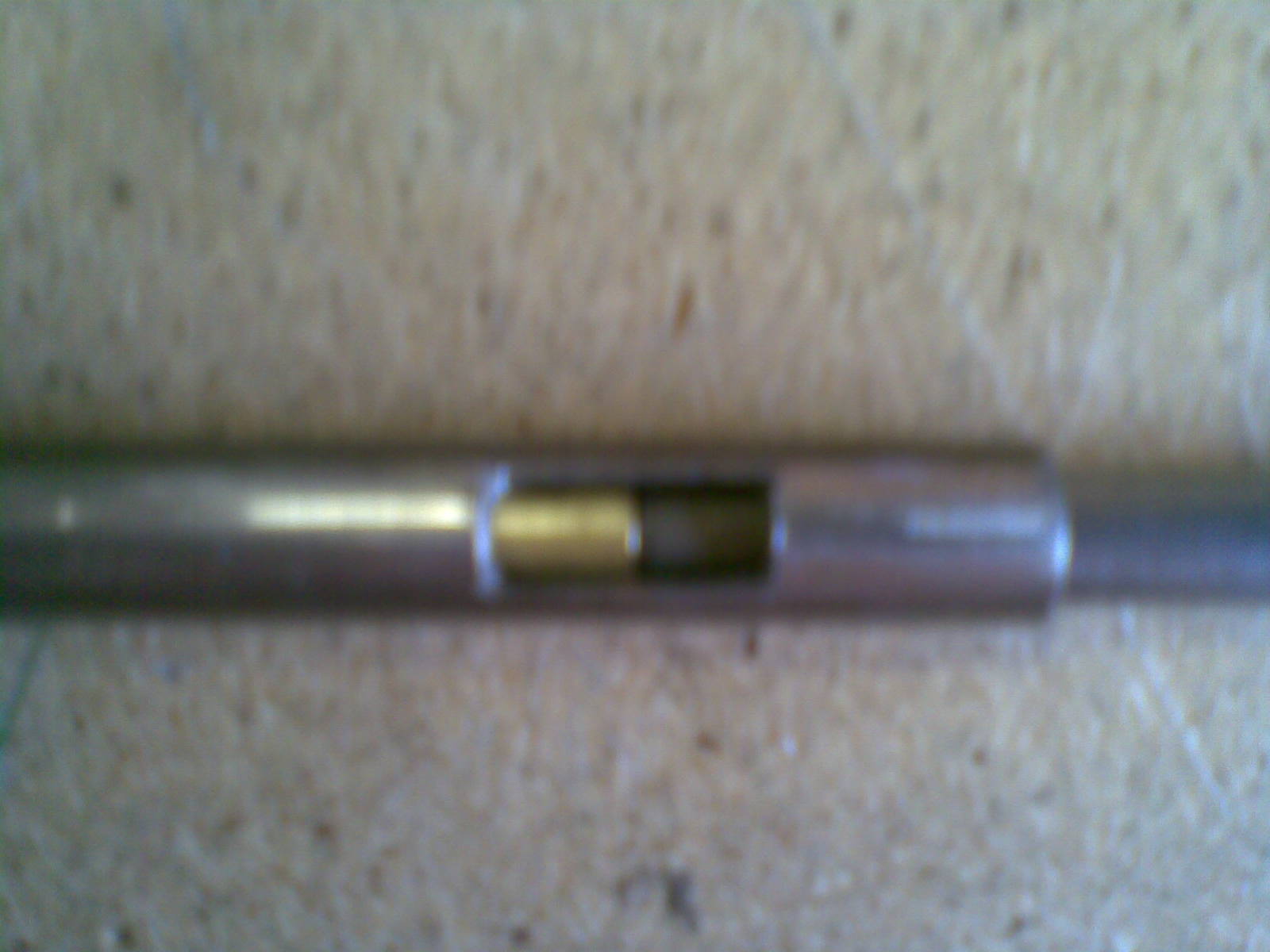

made some progress on the slide now to let the glue set. boring
anyone know how to rifle a 6mm - 1/4inch I.D steel barrel or how to make a tool to do it?
cut out in two barrels with the slide and projectile in the middle. dremmels are
all the pieces of the mechanism <br />slide hasn't been cut to length at this stage.

dyldo wrote:i wish i made that fitting. i had someone else make it for me (:
Tell me about it, I hate the "curing" phase of the build :(
It's easier and probably cheaper to buy a 0.25" airgun barrel
