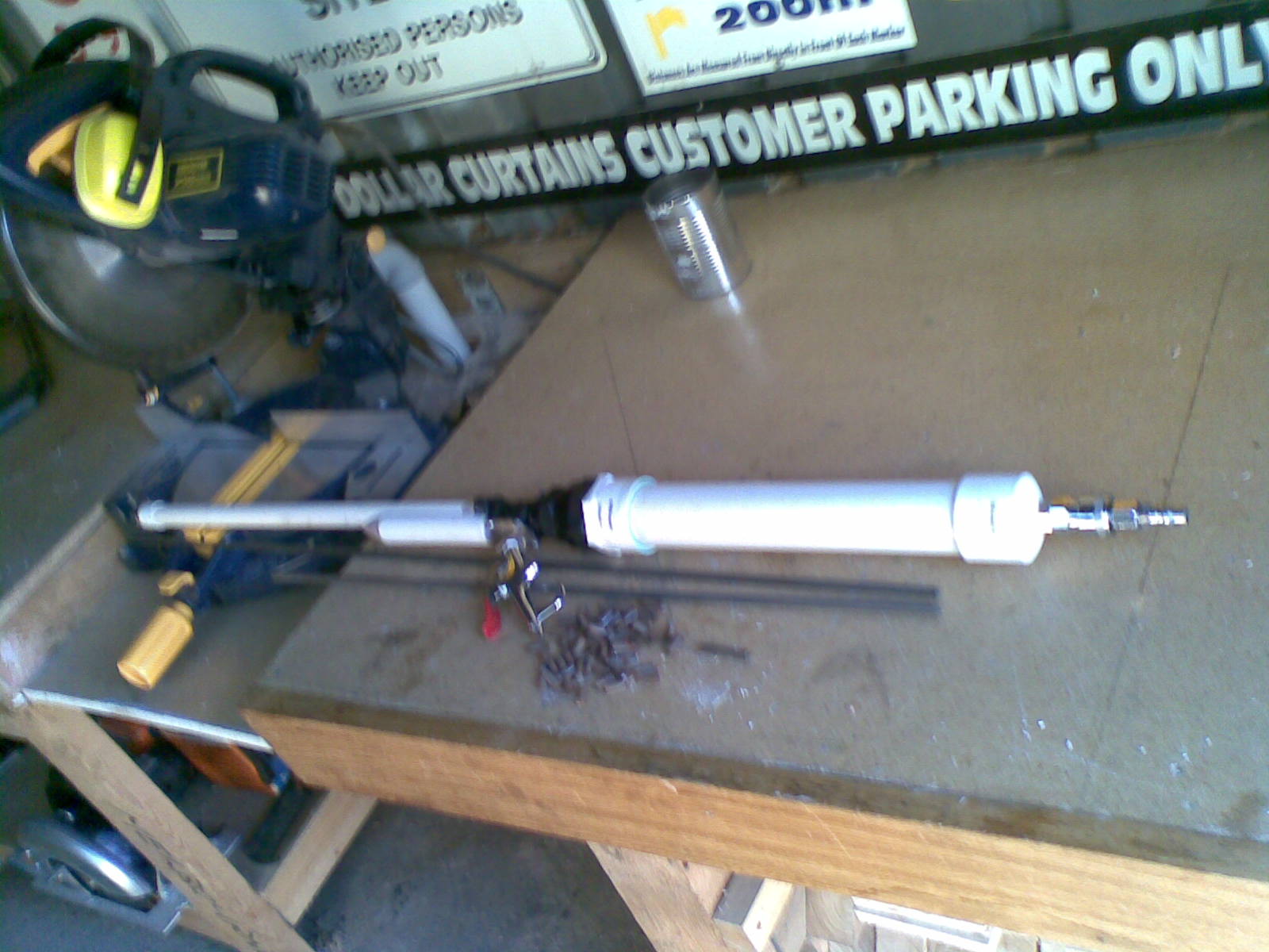

the semi-auto mechanism isn't working its not moving forward enough to cover the hole and the spring isn't reseting it so iv giving up for a while:(
i have put this together
hand grip
hand grip
6mm barrel inside 18mm pvc
Has thanked: 581 times
Wed Dec 26, 2007 10:07 pm
dyldo wrote:the semi-auto mechanism isn't working its not moving forward enough to cover the hole and the spring isn't reseting it so iv giving up for a while:(
Sorry to hear that - perhaps there is too much friction in the system?
